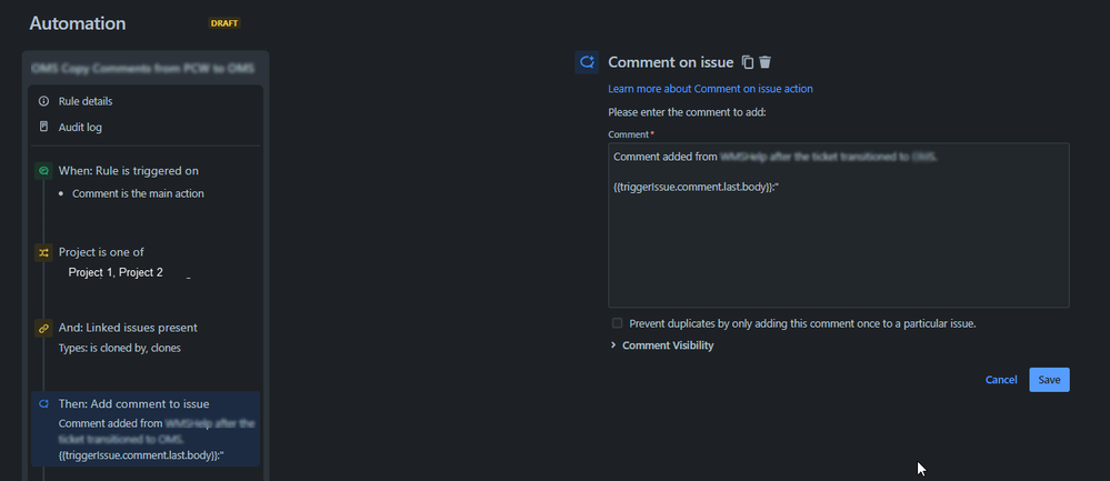

Hi,
I see this old solution https://community.atlassian.com/t5/Jira-questions/Copy-Comment-to-linked-Issue-when-new-comment-is-added/qaq-p/1604705 but it is not working for me.
What the "{{triggerIssie.comment.last.body}}:" is doing for me is passing blank comment to the triggering/original issue instead of to the cloned one.
What I want is that any comments added to the triggering/original issue are copied/passed to the new CLONED issue.
Here is my rule:
When rule is triggered : Comment is the maun action, Comment is added during status transition and Comment is added while editing the fields.
PROJECTS:I had both projects I am concerned about, also tried with just the original orject but it didin't work.
AND: Linked issues presents. TYPES: Is cloded by and Clones.
Then: Add comments to issue with "{{triggerIssie.comment.last.body}}:"
Please help and also with the howto for passing any attachments sent after cloning as well.

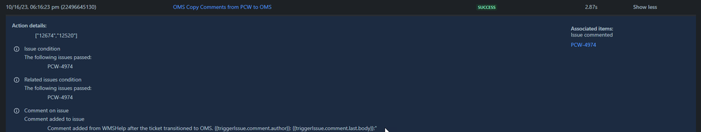

Here is the output
The Automation Log doesnt log a thing, although it is doing something...
Here is a fresher view, the rule details dont seem to get logged for some odd reason, although the output shows it is executing.
Thanks much!

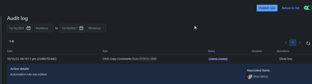

Can you provide the output shown in the Audit Log for the execution of the rule also?
Irina Lemus
October 16, 2023
Added both. Thanks again @Trudy P Claspill !!
Trudy P Claspill
October 16, 2023
In the Audit Log there will be two types of entries.
One type of entry is made when you change the rule and click the Publish button. Those entries show a status of "CONFIG CHANGE". That is the type of entry you've shown us.
The other type of entry is made when the rule executes. That type of entry will be made only if an event occurs that matches the Trigger and it happens in one of the projects specified on the rule's Rule Details page in the Projects field. The execution entries will have statuses like "Success", "Some errors", and "No Actions Performed".
Please show us the details of the most recent Audit Log entry that does not have a status of Config Change.
Also please confirm that the Rule Details page Projects field lists the same projects that you have in the second component of your rule.

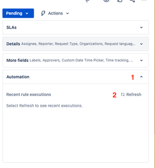

To confirm which rule is getting executed, go to an issue where you believe the rule has executed.
1. Expand the Automations panel.
2. Click the Refresh button to reveal the most recently executed Automations.

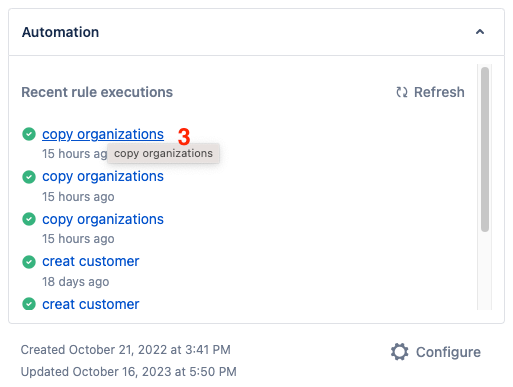

3. Click on the link for the most recently executed automation. That will open that specific rule's configuration screen.

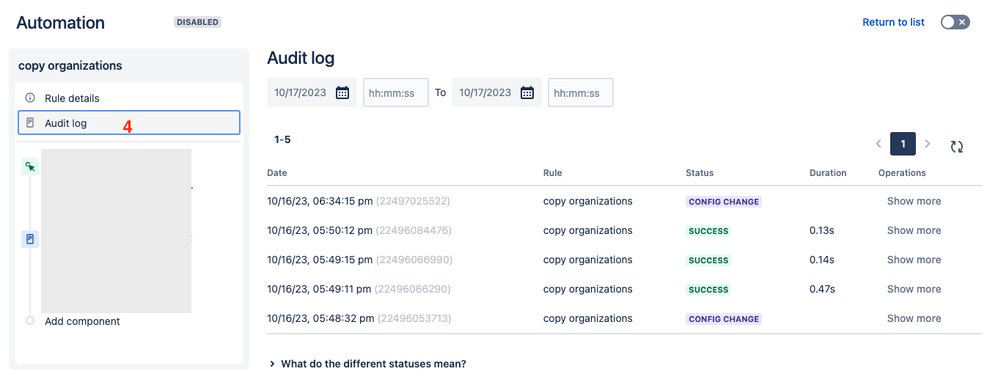

4. Click on the Audit Log link. That should show the log entry for the rule execution you clicked on in step three.

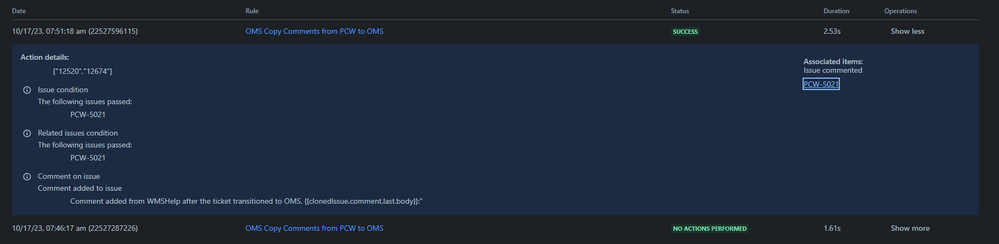

Irina Lemus
October 17, 2023
Interesting. I don't know why it wouldnt show the execution from the previous screen but I see how it is being successfully executed thru the ticket itself. Thanks for sharing how to find it.
Here is what I see. I changed the wording there to Cloned sisnce the Triggering wasn't working
and here is with the Triggering issue
Trudy P Claspill
October 17, 2023
Jira doesn't prevent you from having multiple rules with the same name. Perhaps that is the case here and you were looking at the wrong rule.
The Audit Log of this rule says you are trying to use this smart value to add the comment.
There is no such smart value as {{clonedIssue}} so with this rule there will be no comment to find.
Please show us the details of the rule associated with this Audit Log.

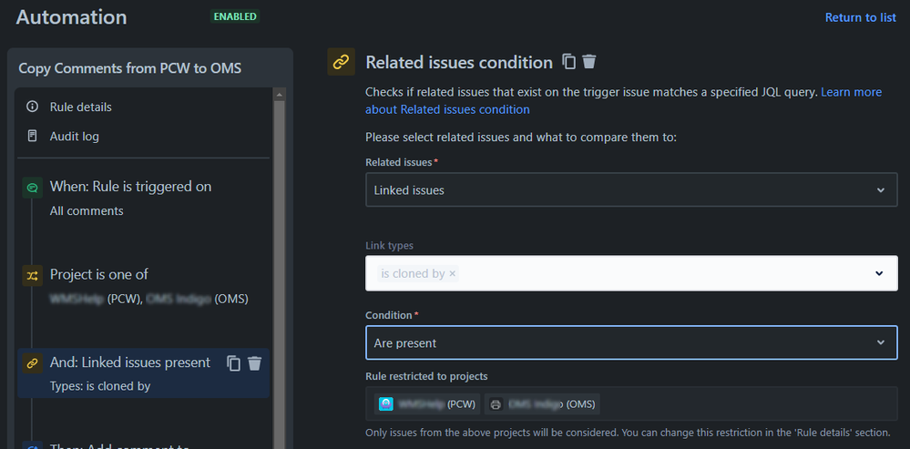

I got the rule to execute but it is now failing this comment "Comment on issue
Error adding comment to issue Comment body can not be empty (comment)"
Below are all the relevant screenst, LMK if I could provide another one.
Input ticket (Service Project)
Output ticket (Software Project)

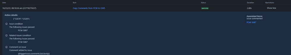

I see now that you are trying to use {{triggeringIssue
That also is not a valid smart value.
As I said in my first response you need to be using {{triggerIssue

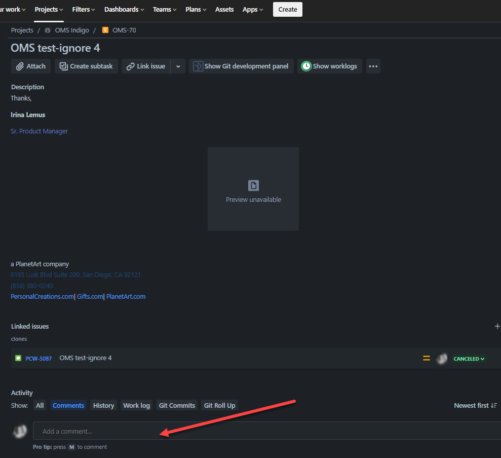

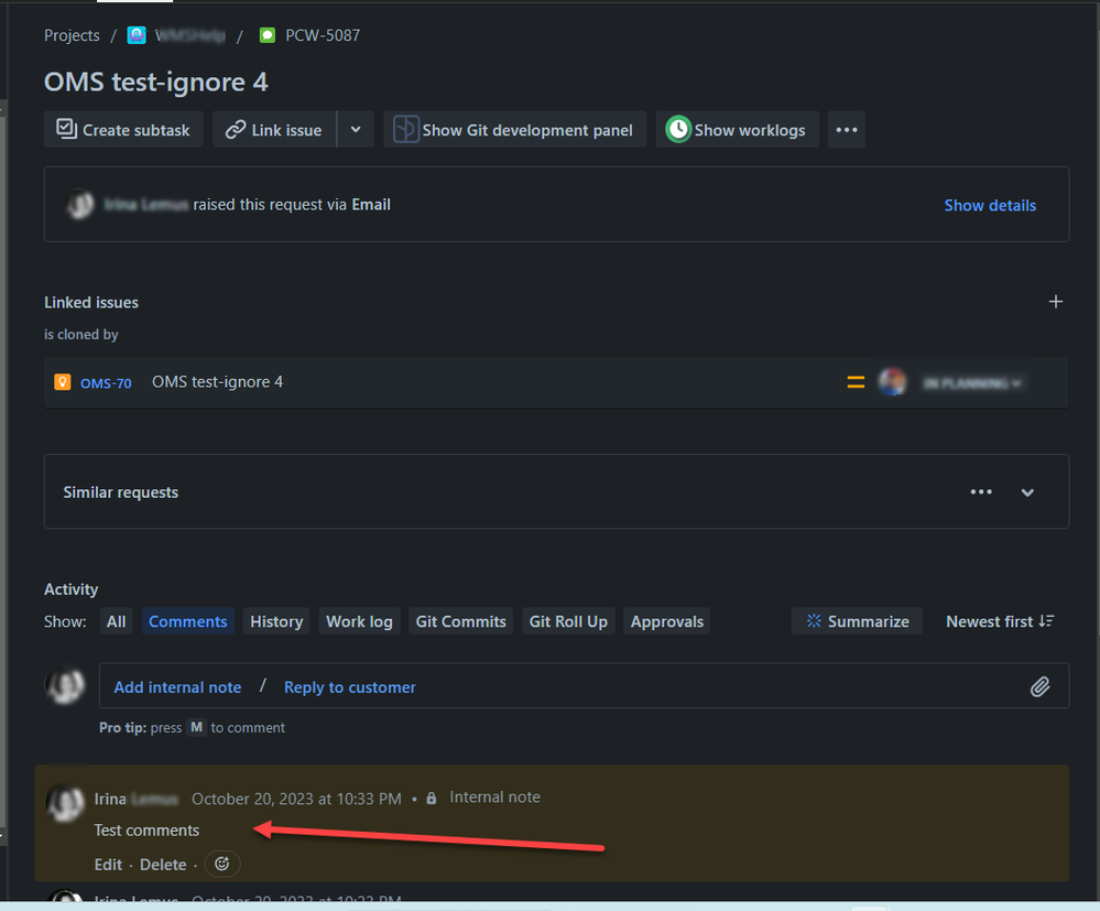

I changed the smart value to {{triggerIssue.comments.last.body}} and though the message is posted on the trigger issue, i need that same message to actually be passed to the "Cloned" issue, not the one in which the comment is already being entered. Here are the screenshots.
I entered the comment on PCW-5087 and expect it to be copied to OMS-70. However, the comment is copied on the same tirrgering issue, not on the cloned issue.image.png

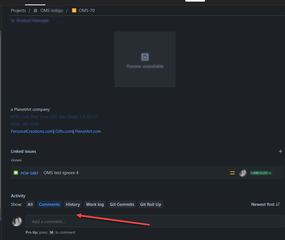

OMS-70 has no comments added. Is this fixable?
Trudy P Claspill
October 23, 2023

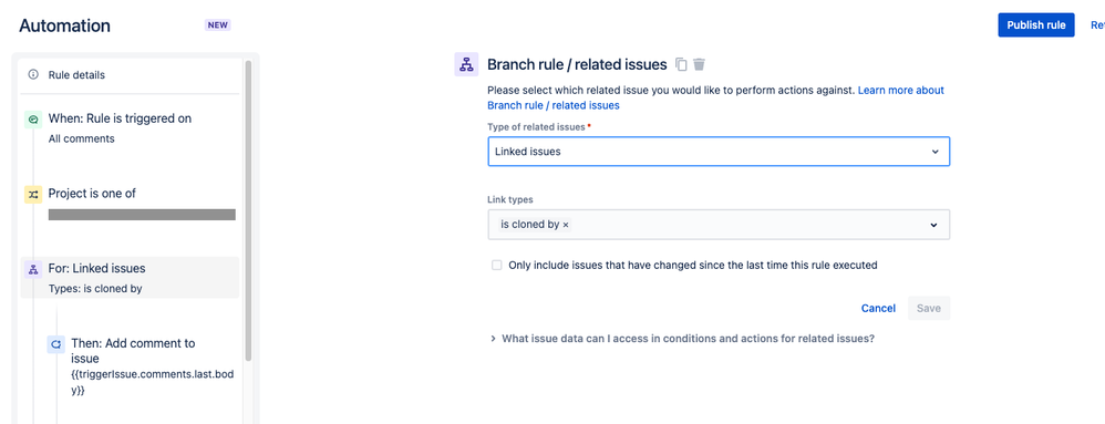

I apologize. I failed to notice that there is a step missing in your automation rule.
You need to set up a For branch to drill into the linked issues to update them.
I recommend you structure it like this:
