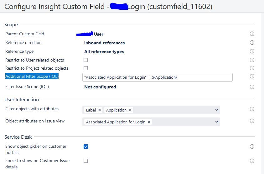

Hi all,
i have the following situation - a Insight Custom Field with reference typ - inbound connections, this is working well, but additionaly i wanna use the "Additional Filter Scope (IQL)" to filter the visible/chooseable entries based on another Insight Customfield (selected in the same Service Desk Request. I tried the following:
Were "Application" is the Name of the other Insight custom field...
...with the result getting this Error Message:
Error
<iql,Placeholder not supported in current context.>
Is there another way to make such a filter?
Thank you in advance
Regards Marco

Hi Marina,
tried the same in the Filter Scope field - same error -
Error

Hi @Marco Hasenfratz ,
unfortunatelly I don't think this is possible. AFAIK there can be only one parent custom field.
