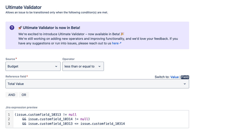

Hi @Santhosh Raj
I’m from Forgappify and wanted to share that we’ve been working on a more flexible way to build conditions using Jira Expressions. This led to the Ultimate Validator (now in Beta), which is part of the Workflow Building Blocks for Jira app. It lets you use most of the power of Jira Expressions—but without writing code. Instead, you build conditions through a simple UI.
With it, the comparison of fields is quite straightforward. Here’s how the configuration for your case would look:
I hope it will help,
Cheers

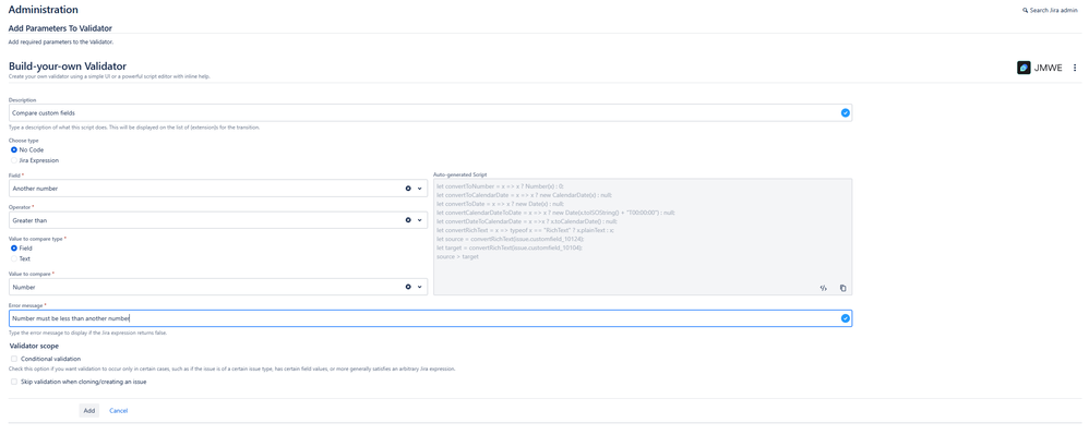

Hi Ismael,
I’m a Support Engineer at Appfire, here to assist you.
If you’re open to plugin suggestions for simplifying your process, I recommend trying JMWE for Jira Cloud.

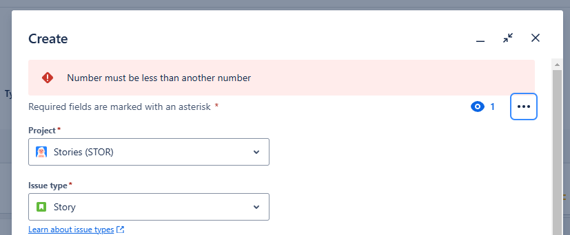

With this, you can add a validator when the issue is created and build your own validator to compare both fields. See the sample images below.
For more details, you can check out our complete documentation here. If you have any further questions, don’t hesitate to reach out to our support team—we’re always happy to help!
