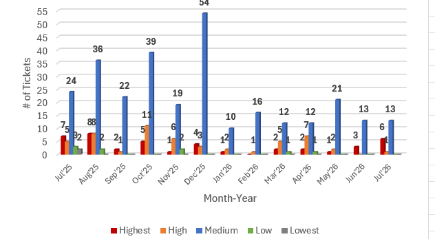

I want to create a dashboard where x-axis will be month through of the year and y-axis will be group of no of incidents which has status (New, inprogress, hold, close)...

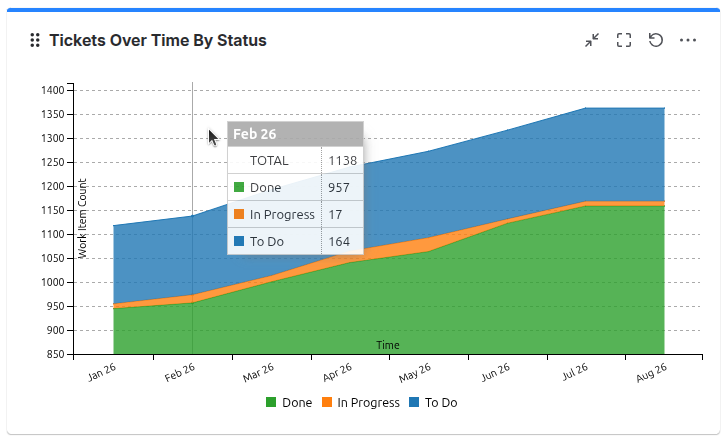

Jira does not provide such dashboard gadget. For achieving this, you will need an app (plugin) from Atlassian Marketplace.
If you are willing to try a plugin, our Great Gadgets app offers some gadgets that can be helpful for this. For this case I would recommend using the Cumulative Flow Diagram gadget.
But you can also try the WIP Run Chart gadget offered by the same app.

I am using JIRA web page inside the VDI. I want to create the below chart in JIRA. currently I am using excel wherein chart type is column..

Requirement is -> as per the above screen-shot , I would like to come up with dashboard based on the each month(Jan, Feb,Mar....) vs priorities (High, Medium, Low).

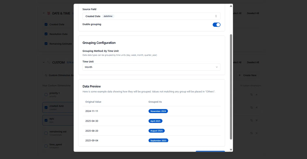

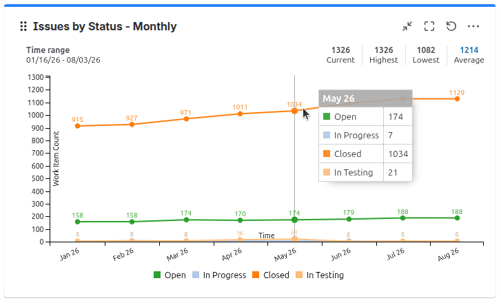

Jira does not natively support creating a column chart on a dashboard that groups issues by month and status. However, you can achieve this by using Visionade. Visionade allows you to build custom reports with various chart types, including column charts, and then embed them directly onto your Jira dashboards.
To set this up, a Jira administrator first needs to configure the data source, as managing data sources and custom dimensions requires Jira Admin privileges. Once the administrator handles this backend setup by creating a custom dimension from the Created Date field grouped by month, regular users can then freely build the reports on top of it without needing admin rights.

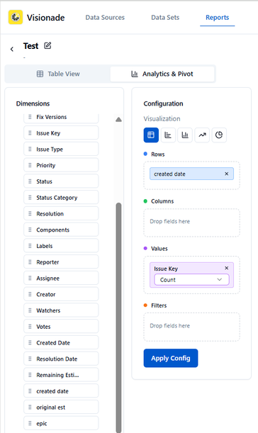

To configure the report, you select your Jira data set in the Table View tab and then move to the Analytics and Pivot tab.
There, you can drag the newly created Created Date grouped by Month dimension into either the Rows or Columns section, and drag the Status field into the other. To count the incidents, drag the Issue Key field to the Values section and select Count as the aggregation. Finally, in the Visualization section, select Column Chart to generate the visual.
Once your report is configured and saved, you can then embed it as a gadget directly onto your Jira dashboard for real-time monitoring.

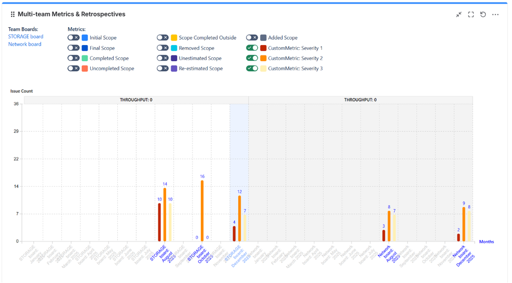

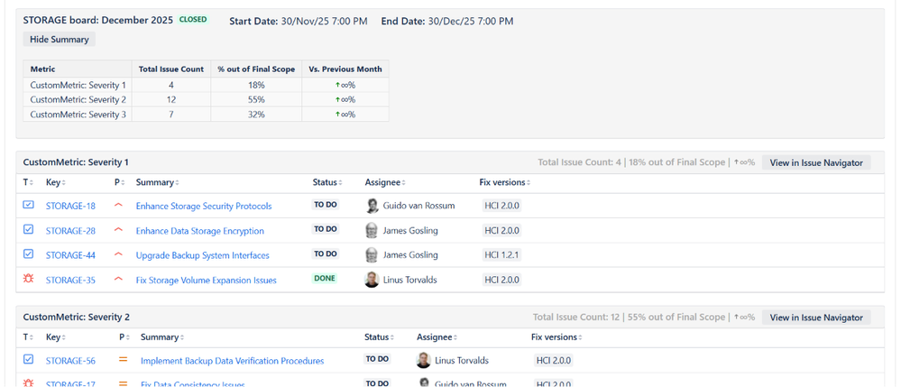

You can accomplish it with the app I developed - Multi-team Scrum Metrics & Retrospectives.
Using the custom JQL metric feature, create whatever filters/metrics you want whether it is priority or status
Using the Measurement Unit (Y-Axis), select Issue Count
Using the Period (X-Axis), you can select Months
Using the Number of Periods, enter as many periods as you need - 12, for example.
And there you go:

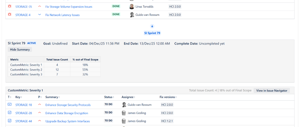

In the same view, you will even be able to drill down into the lower-level periods - in this case sprints:
The app comes with many other features. Also, if something is missing for your use case - let me know, and I will implement it for you most likely pretty quickly.
