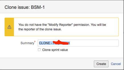

somethingblue
September 25, 2017
Hi Sigridur,
I just tested this and if I clone an issue with a user that has Modify Reporter permissions the reporter stays as the original reporter.  If I clone an issue as a user that does not have the Modify Reporter permissions I do get a warning stating the user will be the reporter and it creates the ticket with that person as the new reporter:
  • When you attempt to clone an issue as a user that does not have modify reporter permissions what happens?
  • Does it matter if the user is an admin or not?
  • What version of JIRA are you using?
Cheers,
Branden
Sigridur Harpa Hannesdottir
September 25, 2017
Hi Braden.
Thank you for your response.
Ok, looked into users and roles and permissions for a certain project. And then the groups the specific user is a part of.
When I look at Users and roles and look at the groups that are under "Modify reporter", the specific user is in neither one of those groups. However, if I go to permissions, I see that the project role for modify reporter in Permissions is both Administrator and modify reporter roles. And the specific user is in a group that is under the Administrator role  in Users and roles (that group is not under the role modify reporter in Users and roles).
Could this be the problem? The user does not get any notification that she does not have "Modify reporter" permission and the reporter is cloned as well.
I tried this myself, and as you said, as soon as I took away my permission to modify reporter, I got the notification and became the reporter.
Really hope you understand what I am trying to say.. If not, please let me know.
