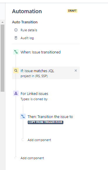

Hey @Anonymous
Automation is ready !!
Please navigate to Settings --> System --> Global automation.
There "Create Rule" and do this configuration.
Trigger: Issue transitioned
Condition: Select JQL Condition and add a JQL for your Project X and Y
Branch: For Linked Issues

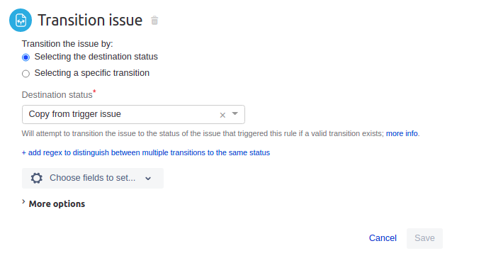

Action: Transition the issue (Copy from trigger issue)
PFA
Take a look at automation playground here https://www.atlassian.com/software/jira/automation-template-library#/
Let me know in case of any queries.

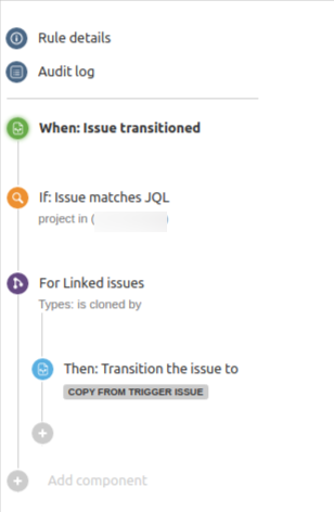

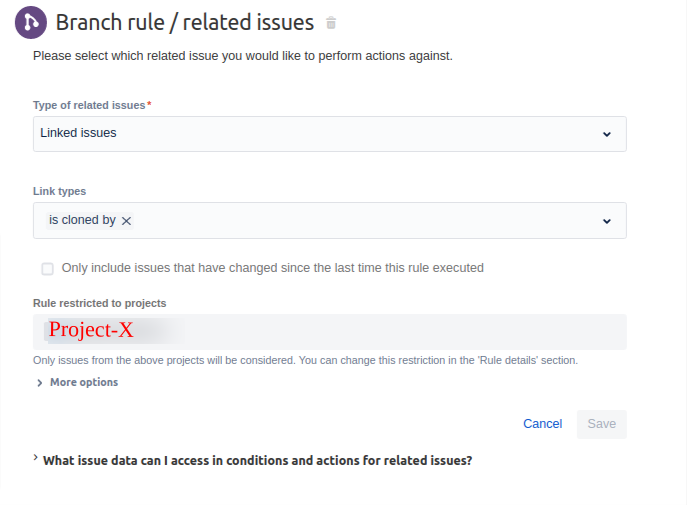

Anonymous
January 12, 2022
Hi Vishwas,
I follow all the steps as it is you mentioned.
Trigger: Issue transitioned (Details Kept Blank)
Condition: Select JQL Condition and add a JQL for your Project X and Y (project in(Project-X, Project-Y))
PFA

Vishwas

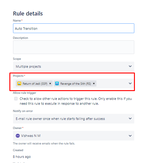

January 12, 2022
Figured out the issue, you need to put the both project x and project y in the scope of automation. Like this
Let me know how it goes
Like # people like this
Anonymous
January 12, 2022
Hi @Vishwas,
Now our rule is working fine and giving the correct output. Thanks a lot !
For your support and quick responses.
Thanks & Regards,
Anonymous.

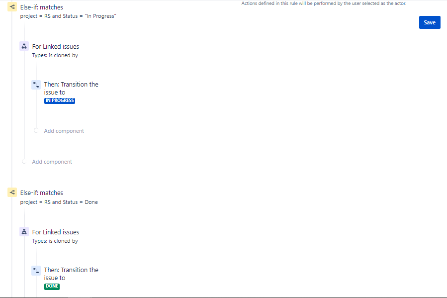

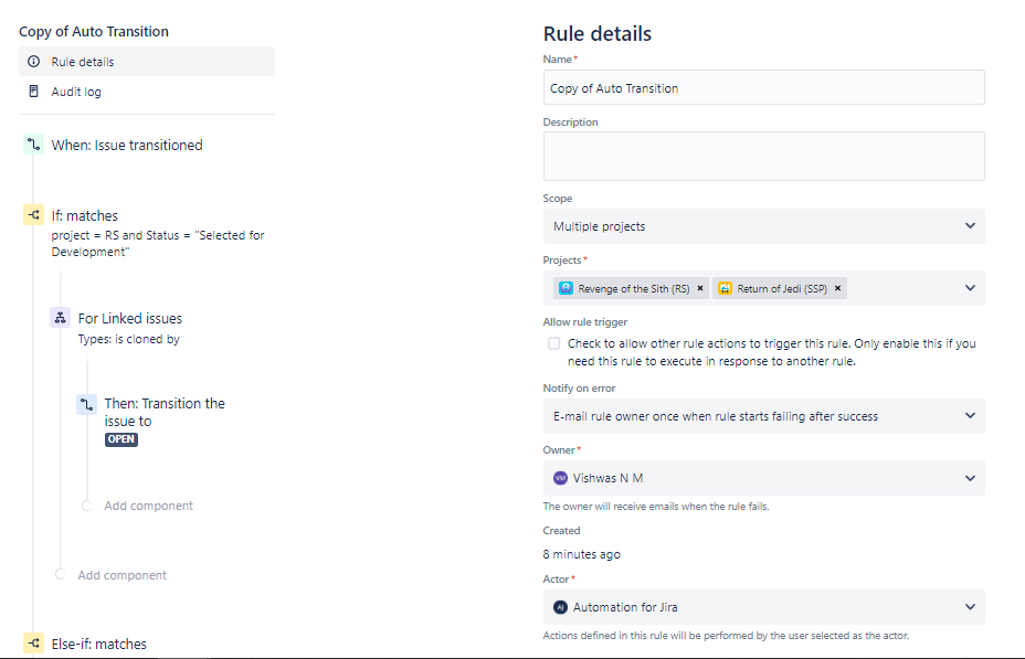

Vishwas
January 18, 2022
Hey @Anonymous
Sure I have tried the automation one way, like from Project X to Project Y.
You can write 2 automations like the ones shown in below.
Notice that I have given condition in JQL for one project if status is so and so then for branch in linked issues in other project of type "cloned by" change the transition to so and so.
In another rule you may have to write other way around providing other project in JQL and status, important is in branch for linked issues of type "clones"
Let me know in case of any doubts.
Regards,
Vishwas
