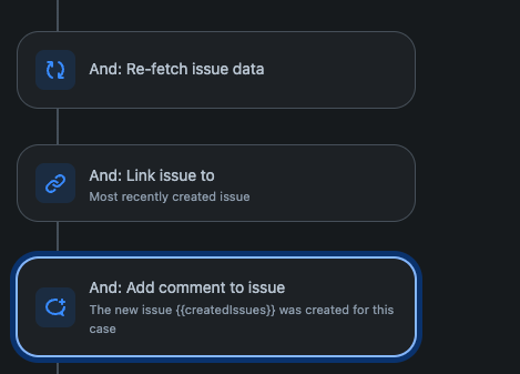

As you are using automation to clone the issue, it would also be possible to add a comment to the trigger issue with the new issue created:
Just use the smartvalue {{createdIssues}} and re-fretch issue data as per the example:
