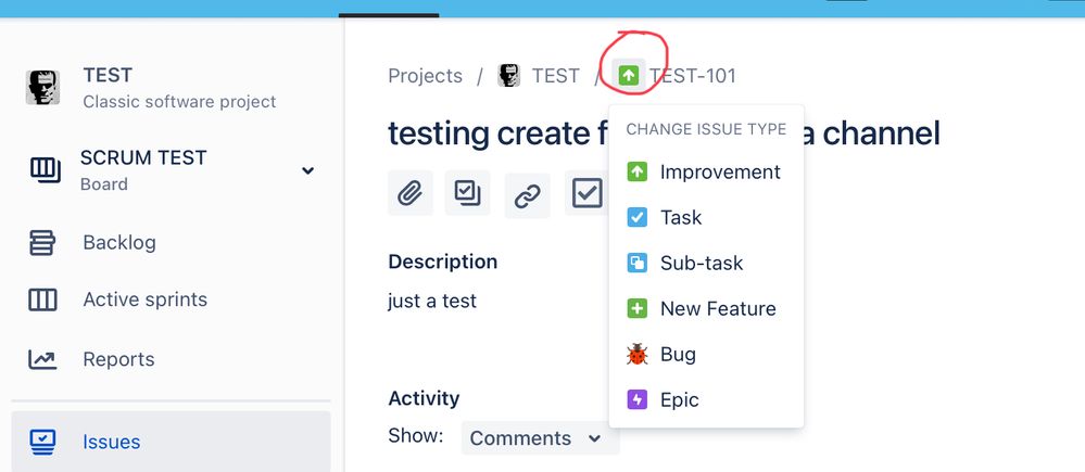

Jack Brickey
March 2, 2021
Note too that the method has changed in the new issue view which we will all be relegated to this month. In the NIV you click on the type icon.

@Jack Brickey thanks.  We're already using the new issue view - your screenshot shows what I'd tried to describe a little more clearly!
