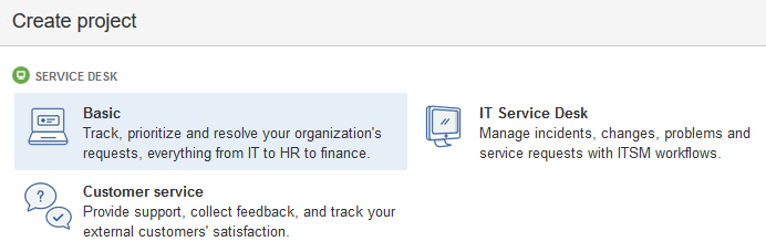

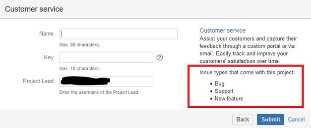

I have created own request types for our service desk. I deleted the others because we do not use them. But everytime I create a new project it creates the standard request types again and allocates them to the project.
Is there a possibility to change the default request types for creating a new project? Or maybe create an own project type "variant", e.g. Service Desk comes with Basic, Customer service or IT Service Desk (see also attached screenshots). Can I create an own one?

The project creation templates are not configurable that way.  They're actually small add-ons that tell Jira how to build a project.
To change the issue types they try to create, you'd have to hack those add-ons (or, better, copy them, and adjust them to make your own versions, then disable the system ones)

Correct. The types are written in the code for the templates, there is no way to change them easily.
"Have to hack" is my short-hand for "write some code (probably based on existing code) that will do what you need"
