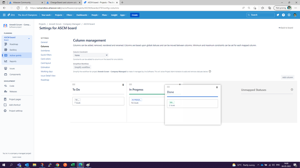

Can I change the Blue color to Green Color without moving the Done to the last in column?
Hello @Anne Nirojini ,

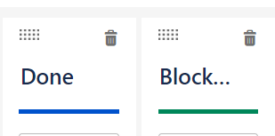

It's not possible. Usually the right most column will be in Green color.
You can Drag and drop the "Done" to the right most. it will be changed to Green color. as below
Hi Anne,
The colors are based on the Status Category of the status you are using. The categories and their colors are as follows:
To Do (Gray)
In Progress (Blue)
Done (Green)
All statuses created must use one and only one of those categories. And you cannot change the color associated with the Category.

Hi @Anne Nirojini
the green color indicates a Done status of the workflow and the states mapped in the last column are used by Jira to obtain all the reports provided for Scrum and Kanban (ex. Burndown Chart)
It is not possible to have two final stages so it is not possible to do what you ask for.
