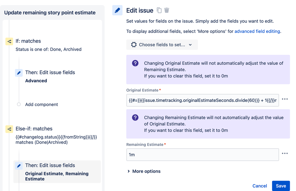

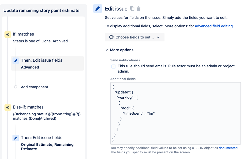

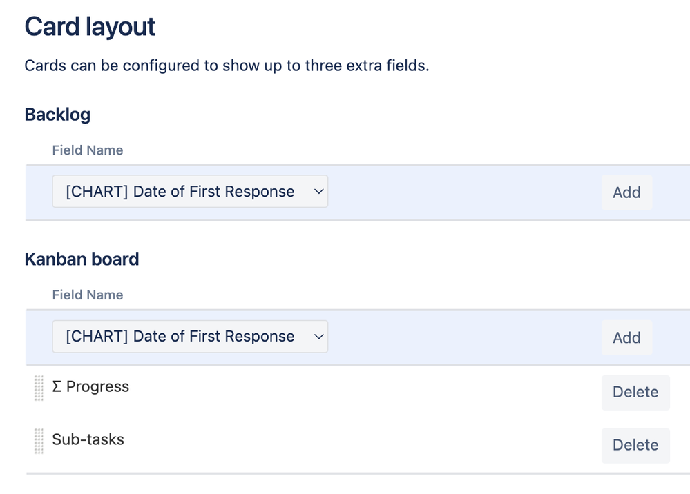

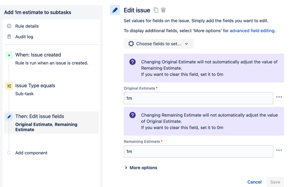

Idan Tene
May 29, 2023
Alright then :)
Here are the automations and the card layout in the board.Screenshot 2023-05-29 at 15.40.22.pngScreenshot 2023-05-29 at 15.40.09.pngScreenshot 2023-05-29 at 15.39.44.pngScreenshot 2023-05-29 at 15.40.56.png
Idan Tene
May 29, 2023
To further illustrate the flow I'm encountering:
  1. I create a new story.
  2. In that story, I create a new subtask.
    1. The subtask automation runs, and sets the original estimate and remaining estimate to 1.
  3. The ticket in the kanban does not show the progress, nor the subtask in the sub-tasks field.
  4. I can repeat (2) and add another task - still no visual update happens.
  5. I can also transition any of the subtasks to done, and the automation works perfectly, but still no visual update happens in the board.
    The story ticket shows None for both fields.
  6. I transition the story to any other status - and only then it updates those fields visually.
