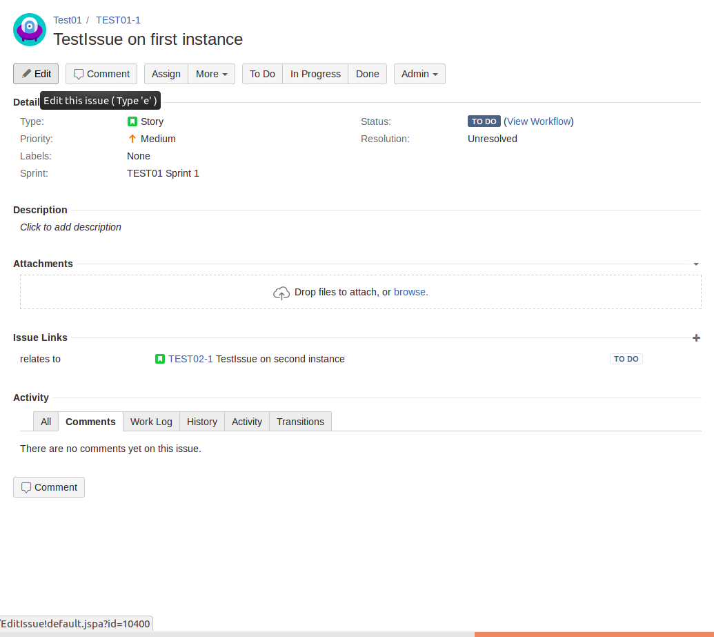

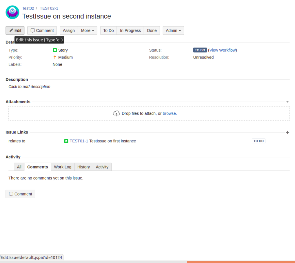

I have 2 Jira instances (01 & 02) which are linked. Each instance contains an issue (TEST01-1 & TEST02-1). The issues are linked to each other (reciprocal link). My goal is to extract TEST01-1 from the link in TEST02-1, therefore I have written the following code:

As the output indicates, the List "allRelatedIssues" is empty and I don't understand why. After all, the Issues are linked, I used the right Issue-ID (see Screenshots) and I performed a re-index just in case. What could be the problem? Does anybody have an idea?
