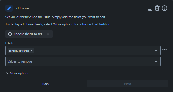

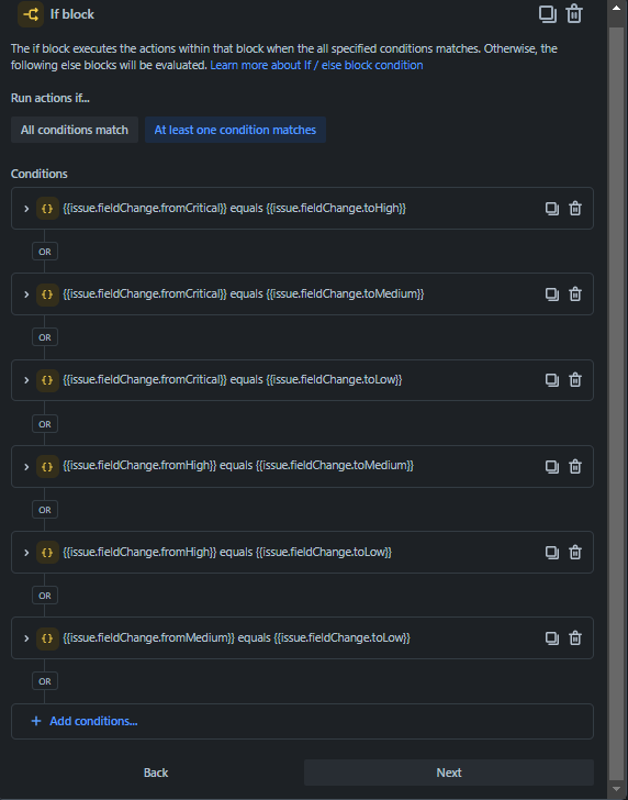

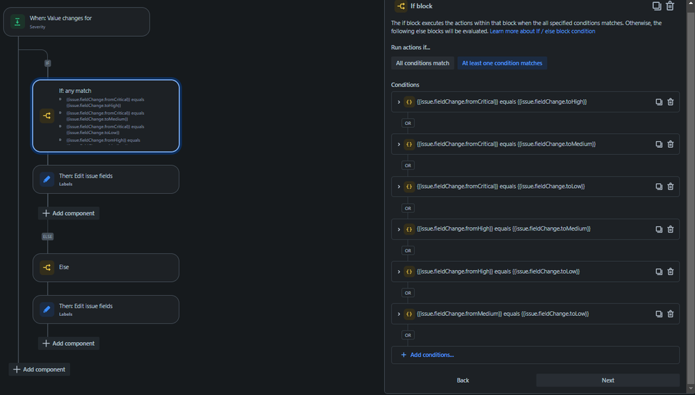

Ok so I can get it to do one of the actions, but not the other...
Screenshot 2024-06-27 175914.pngScreenshot 2024-06-27 180204.pngScreenshot 2024-06-27 180226.png
This is how I've got the first IF block set up, so I've got it going from the higher severity values down to any lower severity value, and adding the severity_lowered label.
The ELSE block is then just for anything that isn't that, adding the label of severity_increased.
The severity_lowered label is applied, even when those conditions aren't met, so going from Low to Critical I still get the label of severity_lowered.
I'm now stuck 😅 do I just need to do another automation that's a mirror for the changes going in the opposite direction? Rather than trying to use IF/ELSE?

Hello @Dean Mervin (He/Him/They)
So, first thing, the smart value {{fieldChange}} should not be preceded by issue.
Don't use {{issue.fieldChange...}}
Do use {{fieldChange...}}
Second, you are trying to access things that are not part of the {{fieldChange}} structure; namely fromHigh, toLow, fromMedium, etc. The {{fieldChange}} smart value has very specific attributes you can access as detailed here:
https://support.atlassian.com/cloud-automation/docs/jira-smart-values-issues/#--fieldChange--
If you want to reference the value of the field before it was changed you use {{fieldChange.fromString}}. If you want to reference the value of the field after it was changed you use {{fieldChange.toString}}
In my environment the Severity values are Sev-0, Sev-1, Sev-2, Sev-3, going from highest severity to lowest severity.

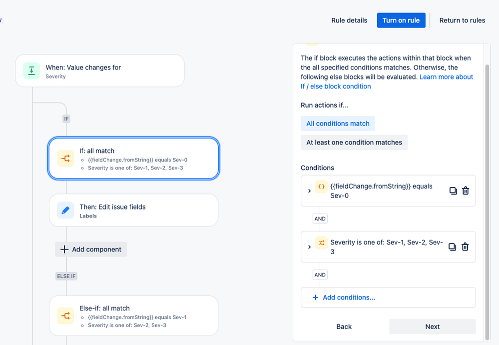

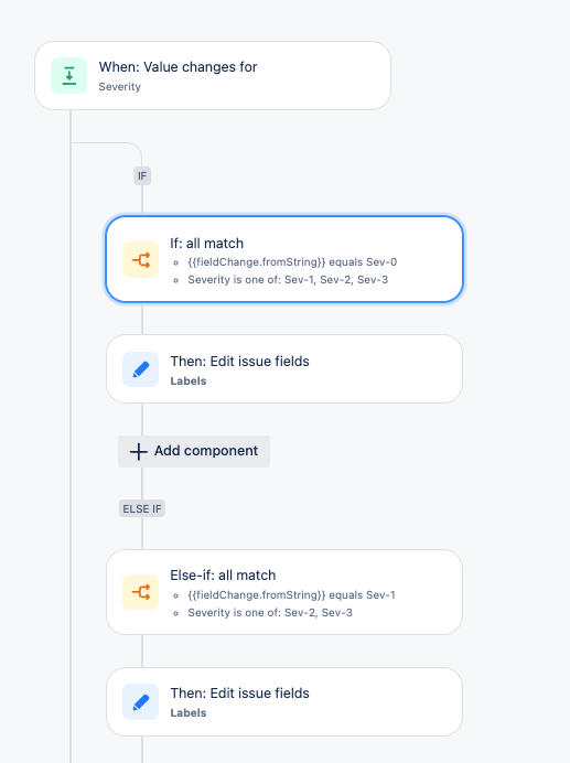

To determine if the Severity has been decreased I can use If/Else blocks like this.

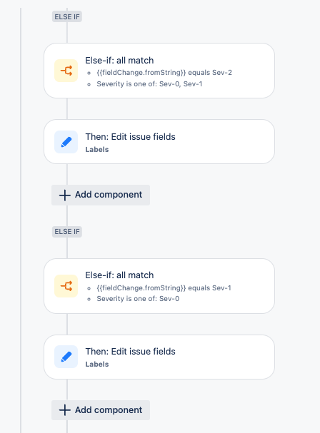

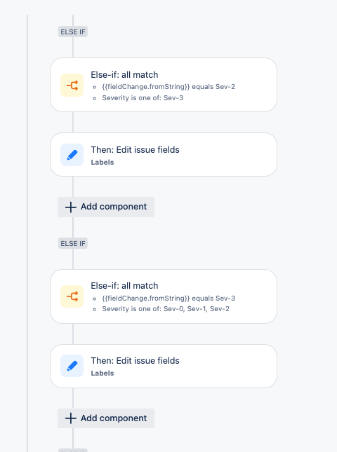

You would make a series of if/else blocks to check for severity decreases, and then a set checking for severity increases.
There may be a more elegant/efficient way to do this, but this seems to work.
Screenshot 2024-06-27 at 10.40.40 AM.pngScreenshot 2024-06-27 at 10.40.55 AM.pngScreenshot 2024-06-27 at 10.41.07 AM.png

You are a superstar, thankyou that works perfectly.
I was getting a bit overzealous adding in the issue bit at the beginning, from past experience I thought that needed to be added in too 🤦
