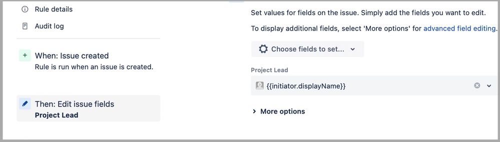

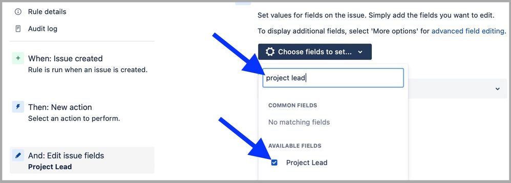

You have to create a single user picker Custom Field first and aptly name it Project Lead and make sure to adjust the context into the applicable project.
Automation set up:
Trigger: <your choice> (ex: issue created/ transitioned/ updated)

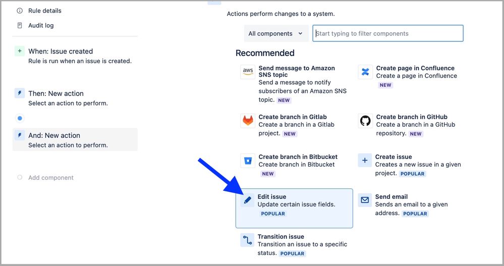

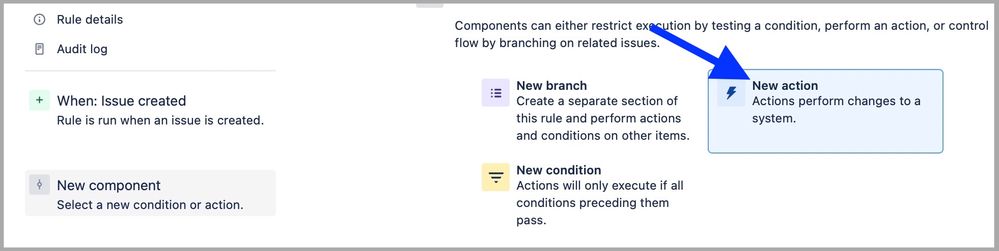

1. Add a new component: New Action
2. Select Edit Issue
3. Key in the custom field name (ex: Project Lead)

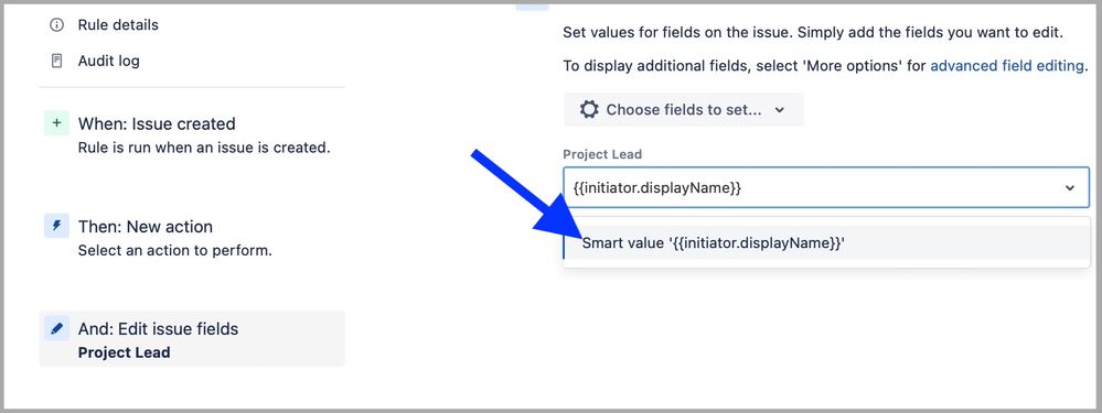

4. Key in the smart value {{initiator.displayName}}; hit Save
01 automation_new action.jpg02 automation_edit issue.jpg03 automation_project lead.jpg04 automation_smart value.jpg

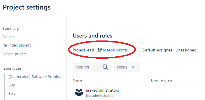

All of the steps of setting up the automation make sense, and I have done so with other custom fields successfully in the past.  However, we do not currently have a custom field named "Project Lead".
Are you saying that if you create that, and set the value, that it adjusts the Jira Project Settings to assign the project lead (i.e. see screenshot below)? This is what I need to do.
Or are you just setting a custom field that is not connected to the rest of the Jira software at all, i.e. it could just as easily be named "Team Leader"?
Ronald Hipol
December 20, 2022
Hi Joe,
You are right. The automation set up I proposed was for any custom field, like you said, could easily be named Team Leader.
I have not tried changing the Project Lead using an automation yet, and I'm not sure if it is even possible. I believe you can only change the project lead in the project settings.

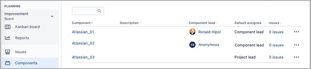

You may want to explore using components if the idea is to have issue groupings like:
Sales request -> lead is John and becomes default assignee
Complaints -> lead is Joe and becomes default assignee
From there, you can create an automation to change the Component Lead whenever the component is changed.
