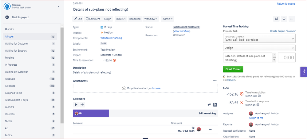

Ugandren Peter
May 16, 2019
Also, your example which shows the Sync function - Where do i find it on my Jira

Hello @Ugandren Peter
The mail above is about the setup of the Tasktop user in your Jira and is not a specification for the sync itself.
Note that Tasktop is a sync solution also, and as you're in the process of deploying it, it will be a better idea to discuss directly with the responsible people.
Let me know if this helps 😃
