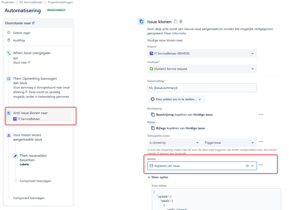

1- the automation rule that clones the issue and assigns the "melder" (reporter)

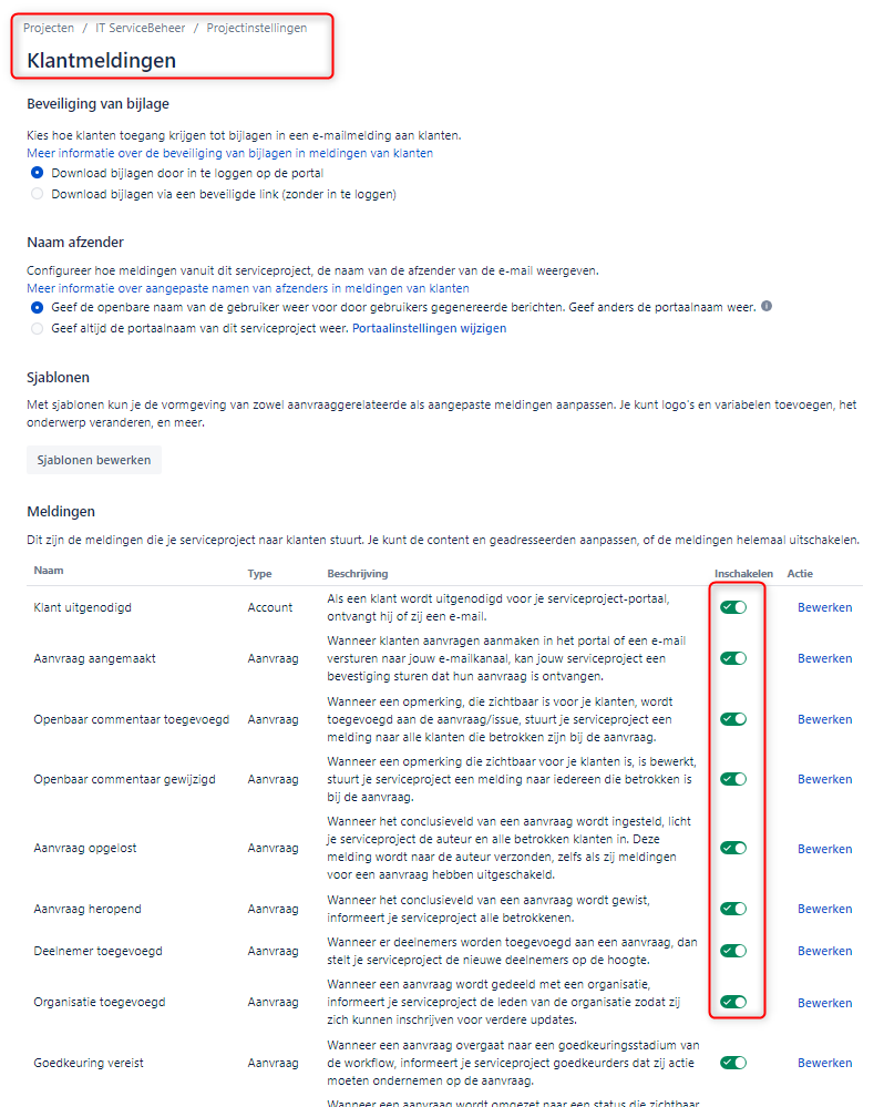

2- the notifications scheme for the project where the issue is cloned to.

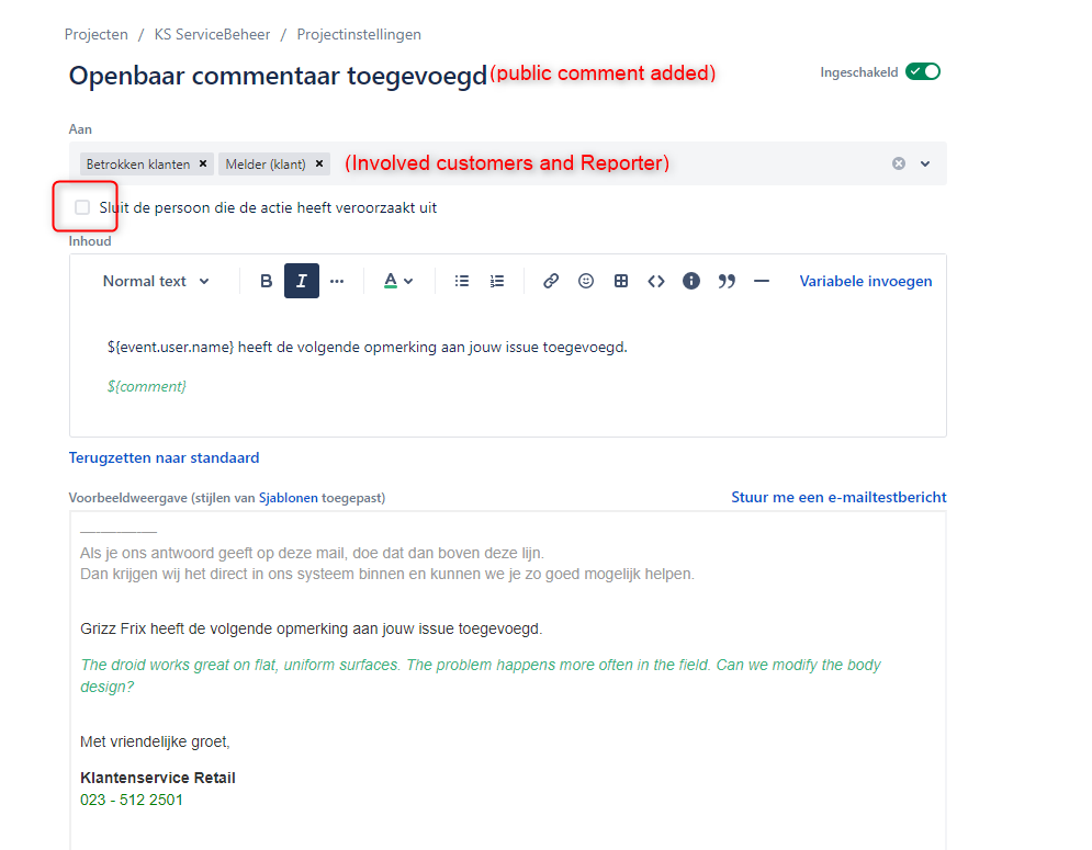

It is being sent to customers involved and to reporter. Checkbox to exclude is off (see screenshot with translation)

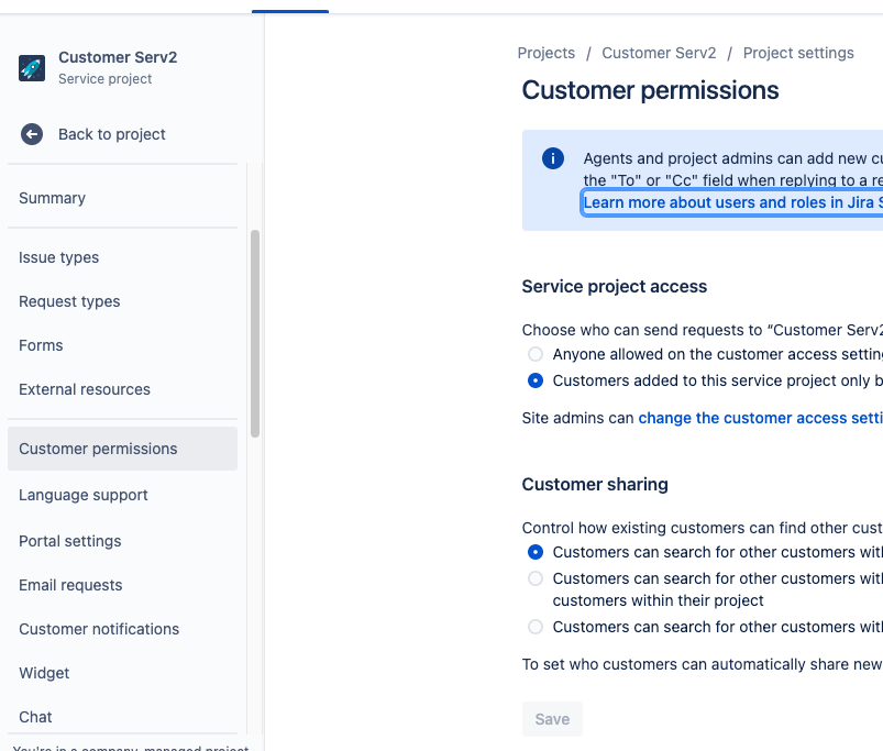

When you clone the issue into a Service Management project and set the Reporter in the new issue to match the Reporter of the original issue, is that user set up as a Customer with access to the Service Management project? Are they able to access the issue using a URL link to either you Jira instance directly or a link to the issue through a customer portal for your Service Management project?

If the Reporter/Customer is not able to see the issues when they are in the IT project, that suggests to me that the Reporter/Customer is not set up to have access to the IT project as a customer.
Is the user able to access the customer portal interface for the IT project and create issues there through the UI?
If not that is another indicator that the Reporter/Customer is not set up with the right access for the IT project.
Do you see the Reporter/Customer listed in the Customers page for the IT project?
What settings do you have for Customer Permissions in the IT project?

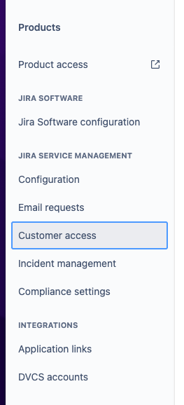

What settings do you have forr Customer Access in the System > Products > Customer Access settings?

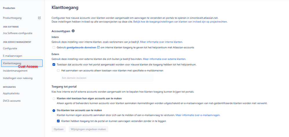

Here the settings on customer access

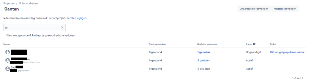

The customer is visible in the list of IT project, but doesn't seem te be connected. (screenshot with privacy marks) When I type @emailaddress of the SebGmail in a issuecomment it doesn't arrive in the inbox.
How can I add the customer to the IT project with the correct Permissions? Maybe in the automation rule like IF customer not exists then add customer?
