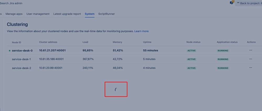

Hi all!
I have installed jira core 9.11.1 and jsm 5.11.1 in dc mode via custom helm chart in gcp k8s.

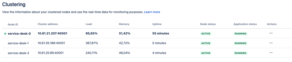

When there is one node in cluster, creating ticket on the top menu is working. If I try to add a second node to cluster, creating a ticket is not working. I just see that the browser hangs indefinitely with a spinning logo at the center.
I have tried to fix it by:
1) Re-indexing and full re-indexing.
2) Copy index from one node to another.
3) Checking database integrity check.
4) Turning off all plugins one by one.
5) Removing information about second node from database and removing the pod pvc.

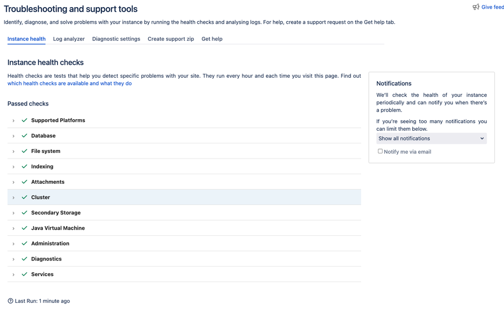

6) Checking clustering page and have seen no issue found.
7) Checking Troubleshooting and support tools and have seen no issues found.
How to fix the issue?

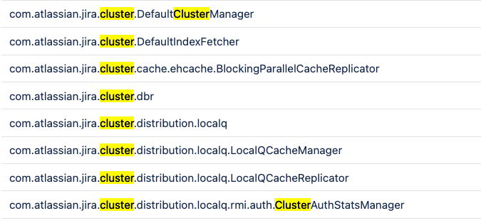

I have turned on debug mode for logger below and turned off other ones.
In log, I have seen the following:
