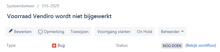

I can't mark my incidents / issues as done. My colleagues gave me all the rights they got but I only see the following options.
Edit Note Assign Progress Start On Hold Administrator

What do you mean by Mark incidents as Done? Could you attach a screenshot?

Do you mean that you do not have the Done button among these buttons? If so, then it means that there is not transition from the NOG DOEN status to the Done status. You should modify the workflow.
