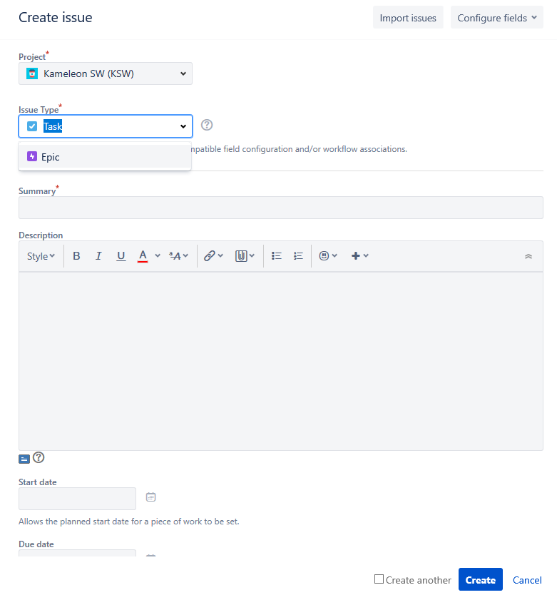

I am unable to add subtasks in my nextgen project.
When I try to create a new issues it only lists "Epic" and "Task".
It also has a small warning: "Some issue types are unavailable due to incompatible field configuration and/or workflow associations."
What should I do to enable subtasks?
Thanks.

Thanks but this doesn't solve my problem.
I already have Subtask defined - just like in the picture you attached.
The problem is that I can't create new subtasks - they are not listed in the "Issue Type".

ah i see. so you are doing this incorrectly. you do not add sub-tasks under the "Issue Type" using Create issue. You do it under a sub-menu/icon of the parent. For example, for next-gen you click the create-child icon as below.
for Classic you create a sub-task under the more (...) icon when viewing the parent issue.

Thanks a lot. This works for me!
