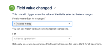

Then, I created the automation:
When:

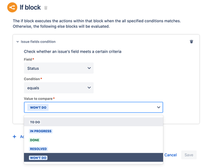

If:

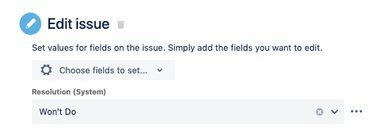

Then:
After that, moving a card to the column, it adds the resolution.

I was using issue fields condition instead of "if block", and for the then part, I was using "Transition issue to".
Anyway I still have some strange behaviour after trying what you suggested. And I don't get why ...
I get for example the following error related to the "if" block:

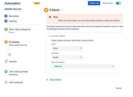

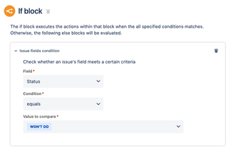

Kamal Hami-Eddine
January 31, 2020
Actually the won't do column is not the last one., as you can see below. The won't do status is in blue.Screenshot 2020-01-31 at 14.47.17.png

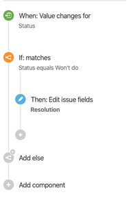

I tried this:

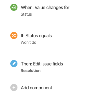

and this as well:
don't know if that makes a difference but none work.
Just a small notice. In your screenshot it is written "Resolution (system)", while in mine there is no "(system)" after resolution. Seems we are not operating the same version.

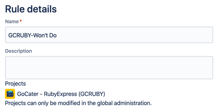

Angélica Luz
February 3, 2020
Thank you for the information and details, Kamal.

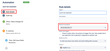

I believe that this "Won't do" belongs to another project and not the project you need. I also faced this issue when created the automation without specifying the project.
Please, go to the Automation rule and click on "Rule details" and select the project:
After that, you will see that only status for that specific project will appear in the dropdown:
Kamal Hami-Eddine
February 3, 2020
I can't edit the project here on my side, but the one listed seem to be the good one... See picture below...
