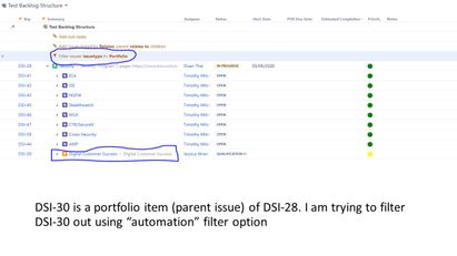

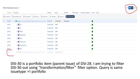

Thank you again for the filter suggestion looks like there two things happening
(1) it just greys out that parents issue if I add it as transformation+filter and do not filter out from the view plus when I hover over the greyed issue I am still able to drill down to child issues under it.
(2) If I am adding a JQL query using the "automation" button it does not work at all. Can you guide me on what I am doing wrong?
Attaching both pictures for your reference
Please help!
atlassian-unlinking issue_automation.jpgatlassian-unlinking issue_transformation.jpg
Thanks!

That's what I meant when I mentioned that issues would have to be in child positions. Issues cannot be completely hidden from Structure without their children, as this breaks the hierarchy. You can hide parent and its children if you restrict the filter to the level of the parent (by default filter applies to all levels and may keep children that pass it).
Sorry for missing your earlier comment, strange that it did not register in my email.

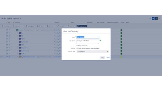

Thanks for the explanation Egor, I did select "current level" and tried to filter out the portfolio unfortunately,I still see portfolio (DSI-30) in the filtered view.  Per you above example I am trying to filter of X and just want to see "y" & "z"transformation filter details.jpg
Egor Tasa [ALM Works]
May 7, 2020
Hi Ramsha,
You cannot filter out parents, they will always be present if their children are passing the filter. One of the alternatives can be: create a different structure and insert issues in structure("Test Backlog Structure", "child of root") this will show you the second level of the first structure, which you can extend with the same extender you used in the first structure to get levels 2 and 3 only.
Regards,
Egor

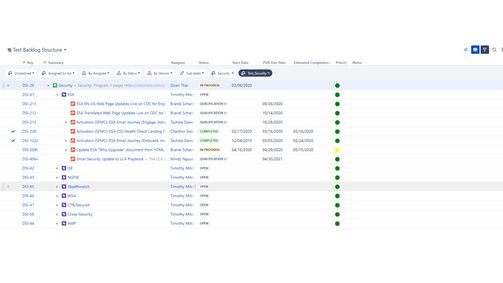

Sorry for being not clear. You'd have to create a new structure and use Automation+>Insert>JQL Query, with JQL issue in structure("Test Backlog Structure", "child of child of root"), this will bring in only program items. Then use the same extenders you have in original structure except for those responsible for bringing in portfolio and program items. Without seeing generators in your structure and links in your issues, I cannot tell which ones exactly are those extenders, but technically you can copy all extenders.
Regards,
Egor
Ramsha Deshmukh
May 8, 2020
A heartfelt THANKS to you! Looks like this alternative is working for my custom structure view. Finally, not seeing the portfolio in there :) . I thoroughly appreciate your help and patience
Stay Safe!
Remove Parent from Custom Structure- final.jpgI am
