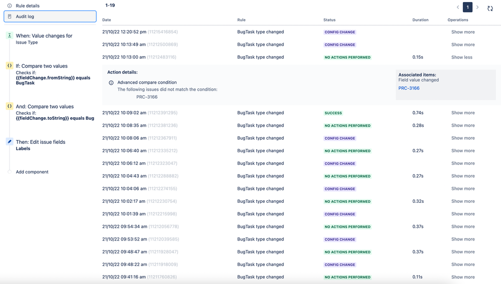

Thanks for getting back to me so quickly. Here is my rule (i changed it quite a few times cause i was trying to figure out why the Advanced compare condition wasn't being picked up) but through some scenario testing i realized that it would only pick up from a normal issue type to another not from a subtask to a normal issue type. (BugTask) is a sub-task type created by us.

That one success use case in the audit log, i had changed the rule to be from Story to Task, but it doesn't work when I do from BugTask to Bug.
