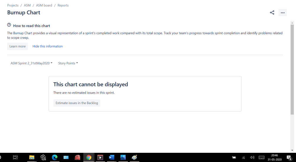

Hi,
I have done the following in sequence:
1. Created user stories
2. Added points to the 'Story point' field for each user story
3. Added some of these stories to a bucket
4. Started the sprint
5. Moved stories to Done in the active sprint board
6. Completed the sprint
In my 'Settings', the estimation statistic is 'Story Points' and the Time Tracking is set to 'None'.

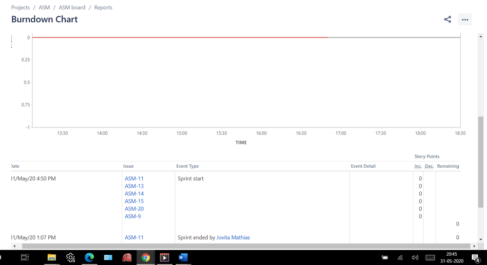

In spite of this, I'm still unable to view the Burn up chart. It says "This chart cannot be displayed. There are no estimated issues in this sprint." And my Burn down chart does not reflect any story points either.
How do I fix this?

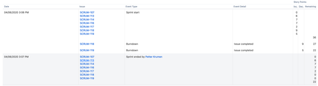

That's a really weird problem... In my test instance, I followed the exact same steps as you and added a Sprint with 1 hour of duration, however, the Story points incrementing/decrementing are properly displayed in the Burndown chart report:

1. Navigate to the Burnup chart, select the sprint and you will get the message (screenshot shared by @Jovita Mathias as above.)
2. Now, to get going... change the selection 'Story Points' to 'Original Time Estimate', you will see the chart populated, now, change the selection again to 'Story Points' and you are sorted :)
