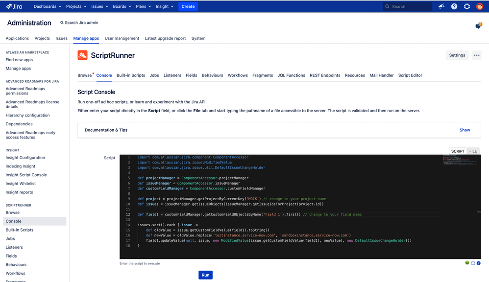

For your requirement, you could use the ScriptRunner console with something like this:-
import com.atlassian.jira.component.ComponentAccessor
import com.atlassian.jira.issue.ModifiedValue
import com.atlassian.jira.issue.util.DefaultIssueChangeHolder
def projectManager = ComponentAccessor.projectManager
def issueManager = ComponentAccessor.issueManager
def customFieldManager = ComponentAccessor.customFieldManager
def project = projectManager.getProjectByCurrentKey('MOCK') // change to your project key
def issues = issueManager.getIssueObjects(issueManager.getIssueIdsForProject(project.id))
def field1 = customFieldManager.getCustomFieldObjectsByName('Field 1').first() // change to your field name
issues.sort().each { issue ->
def oldValue = issue.getCustomFieldValue(field1).toString()
def newValue = oldValue.replace('testinstance.service-now.com', 'sandboxinstance.service-now.com')
field1.updateValue(null, issue, new ModifiedValue(issue.getCustomFieldValue(field1), newValue), new DefaultIssueChangeHolder())
Please note that the sample code above is not 100% exact to your environment. Hence, you will need to make the required modifications.

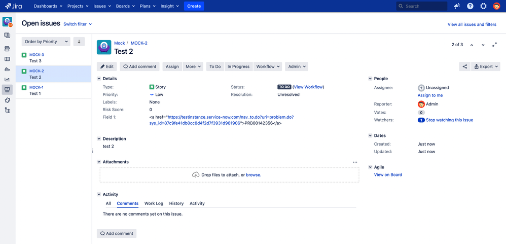

Below is a screenshot of the configuration:-
Also, I include a few test screens for your reference:-

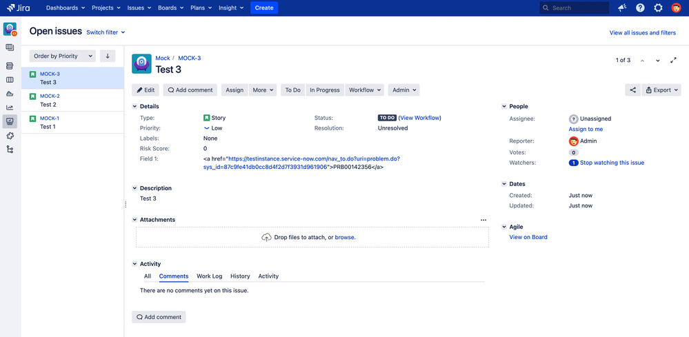

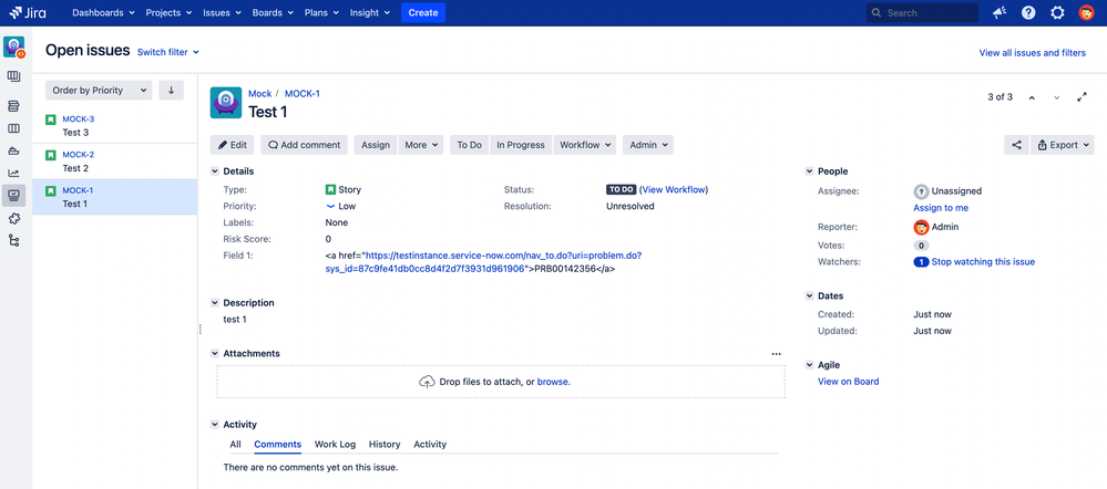

1. Below are some screenshots of when the issues are first created with the old URL:-
If you notice the screenshots above, all the issues MOCK-1, MOCK-2 and MOCK-3 are using the old URL when they are first created. And the fields are set to read-only.

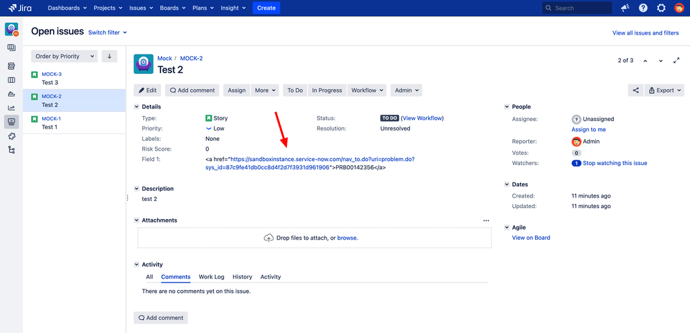

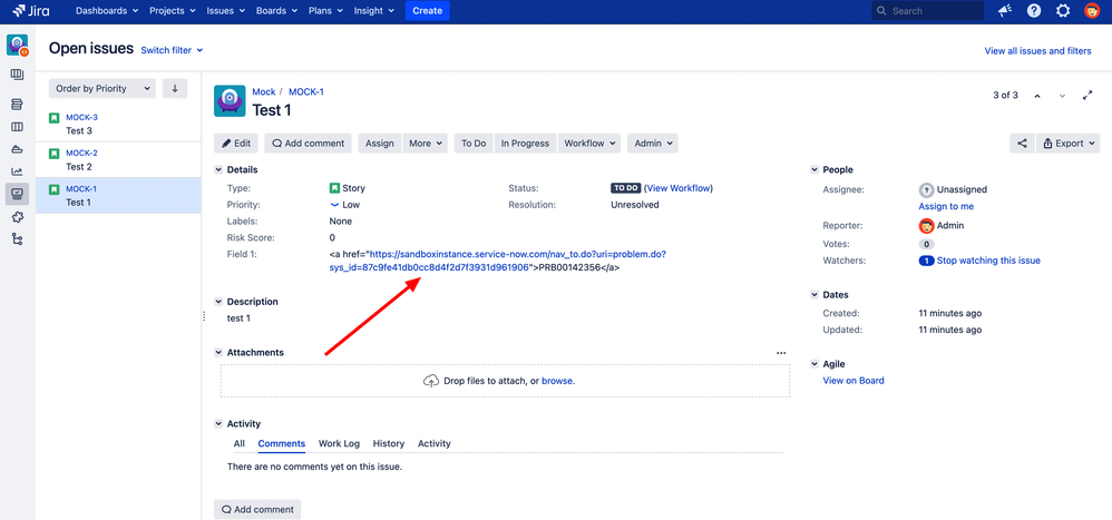

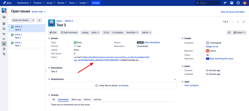

2. Once the script is run on the ScriptRunner console, the values in Field 1 are updated as expected, as shown in the screenshots below:-
