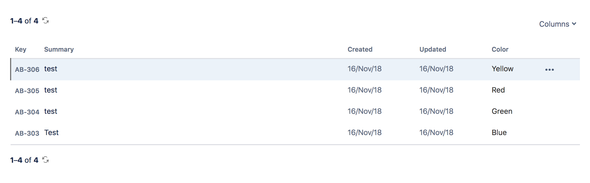

So using the CSV I showed in my last response, these are the tickets that I imported:
None of the values for the custom field "Color" existed prior to my importing. All were created on import. The CSV was structured to create 1 ticket per option, with 1 option per ticket. I do not care about these tickets and will be deleting them now that I have my values imported. This is not how a CSV should be structured if you are looking to bring in the tickets for a project. It will create the values for your custom fields, but it will not set them correctly on your tickets.
If you wanted AB-306 to have colors "Blue" and "Green" on import and AB-306 was an actual ticket you cared about, my method wouldn't work.
