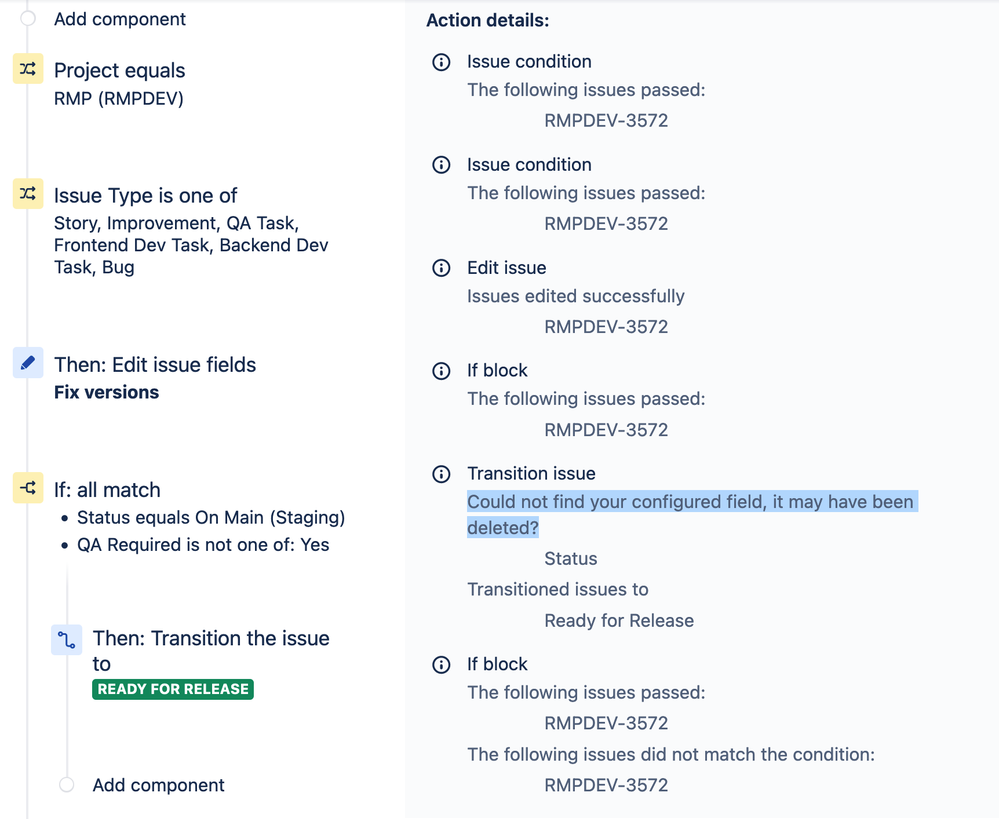

Hello. We've recently made some configuration updates to one of our projects and have started receiving some automation failures. We're seeing the error,
Could not find your configured field, it may have been deleted?
in the detailed audit log. The following is a screenshot of what I'm seeing.
Now, I'm not quite sure what to make of this because I think it's referencing the Status field supposedly being missing. However, the Status field is absolutely present. If this is a case where JIRA has under the hood changed the id of some field, you'd think that it would either and preferably both:
  1. Update the associated automations, and/or
  2. Provide some additional context both in the automation configuration and in the audit log to disambiguate between previous and current fields, if that indeed is what's going on here
Of course, I'm just guessing at what's going on here, since it doesn't seem to be clear. Maybe it's something else; I see some sort of race condition alluded to at https://community.atlassian.com/t5/Jira-Software-questions/Automations-quot-can-not-find-configured-field-quot-suddenly/qaq-p/1624339

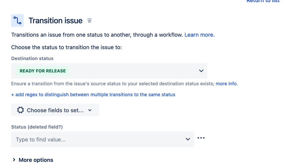

Hi @Andrew Grossman - Without being able to see the specifics of your Transition Action, my first guess would be that there's a field update on the transition action that is no longer available since the changes. It will tell you on that screen if there are any such fields.

Thanks, Mark. So we're talking about something other than the field supposedly referenced here:?
That looks pretty clearly like it's referencing Status.
Andrew Grossman
February 25, 2022
Oh, I see, if I go into that particular rule, I see
But that's pretty unfriendly--why is that not being displayed on each rule summary, plus what would have caused this? I believe that all we did was change some of the allowed values for that field.
That verified what the problem is but I'm still looking for a friendly way to address it.

Ahh - Probably on some older version of automation where status could be set as a field update action rather than a transition.
Agree there's a bit of a learning curve to troubleshooting automation issues, but it makes sense after you've been playing with it a while (at least it did for me).
