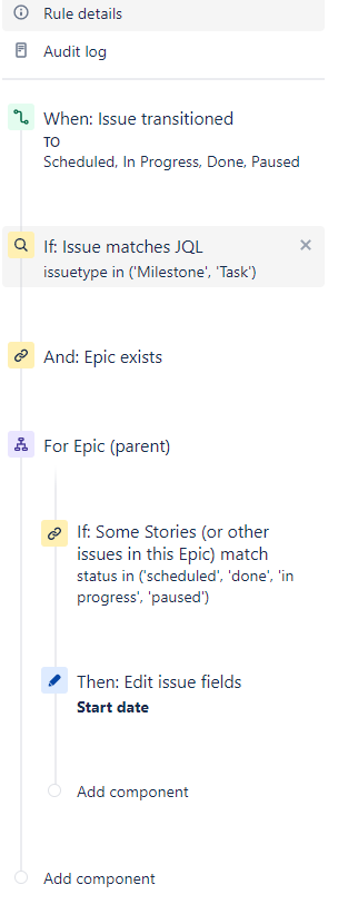

Hello community,
i have 2 automations in place which shall update the EPICs
Due date from the issues in the epic "{{issue.Due date.max}}"  &
Start date from the  issues in the epic "{{issue.Start date.min}}"

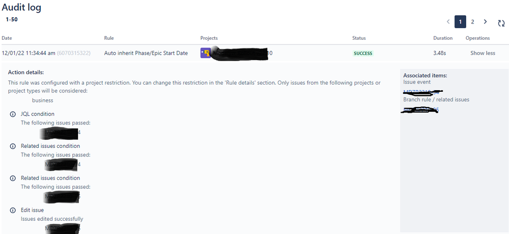

The audit log gives me a success status but nothing really gets added or changed in the epic. When i have already dates set in the epic. The automation overrides the current dates to empty
I used the same automation successful for a level lower. Subtasks to Issues/Stories
Thanks for any advice

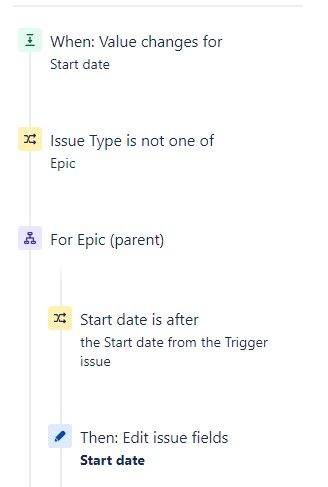

For what it's worth, here's what I implemented:
Every time I update a non-epic issue, I check to see if the start date for the epic is after the updated (trigger) issue's start date.
  • If not, no action.
  • If so, I copy the trigger issue's start date to the epic.
That way, if I create another issue within the epic, and it happens to have an earlier start date, that will re-evaluate the epic's start date and update the epic accordingly.
This became a must-have when we pushed Jira items to ProductPlan for a - supposedly - more robust and shareable roadmap; Product Plan requires that all epics and child issues have dates, and those child issue dates all need to fit within the epic's date range, or it will not sync correctly.
Hope that helps, happy to hear others' thoughts.
