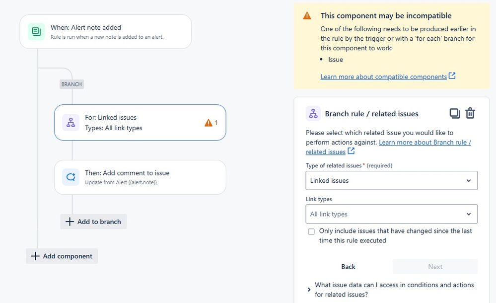

So have just completed the migration of OG into JSM.   The Sync config under Settings, Operations, I thought would create and update incidents from Alert. But it didnt. So I created an automation to create and tried to create one for update:
I did a test against an alert that has a linked issue

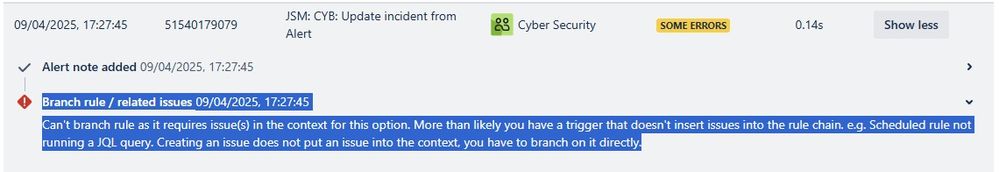

It failed and the logs show:
Everything (not a lot) that I could find states this is how to do it; but I cant make the branc work.
Any ideas, solutions, etc appreciated.

That error you see is because the trigger object is an Alert, not a work item / issue from which to branch to linked items.
I am not using Alerts, but I did find this open suggestion indicating automation rules do not have that linkage information: https://jira.atlassian.com/browse/AUTO-1623
You could confirm that behavior by working with your Jira Site Admin to ask the Atlassian Support Team here: https://support.atlassian.com/contact/#/
They might suggest using the REST API to solve this, so please post what you learn to benefit the community.  Thanks!
