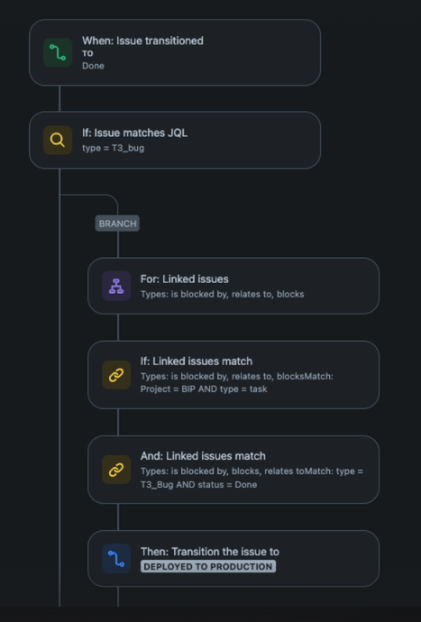

This is the automation currently working with 1 linked issue:
and this is example the use case I want to solve, in the picture below, when these 2 linked issues are in status "done" I need to change the status to "done" also the main task (BIP).

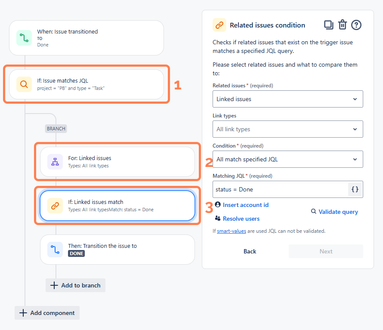

I'd suggest the following approach:
  1. Adjust to your initial query, e.g., check for the issue type "T3_Bug" so that the rule only advances for your issues of interest. In your scenario, that might pass for ONB-152.
  2. You're already correctly switching within the branch to the linked issues. In your scenario, that would make the switch towards BIP-1360.
  3. Verify that all issues linked to this issue (here BIP-1360) are "Done".
I would generally recommend making all conditions and also the linked issues branch query as precise as possible to avoid producing false positives, e.g. by including the link type to the branching component, if this should only apply for blocking issues etc.

Unfortunately I tried this with and without the last linked issue condition - both are didn't work.
The main problem is when I tried to switch to the BIP, I can't reach to it.
Meaning I can only "see" it from the T3 bug as linked issue.
I need to actually to make my conditions on the BIP.
Because T3 will have only 1 linked issue (BIP) while the BIP will have several T3 linked issues

If I understand your requirement correctly, this should work, removing your first "Linked issues match" condition. In your screenshot, there's an AND between the two, and an issue can't be of type "task" AND type "T3_Bug" simultaneously.
Within the branch, assuming your BIP ticket is returned within the "For: Linked issues" component, the components within the tree change "perspective" and the "Linked issues" condition is run against your BIP ticket.
