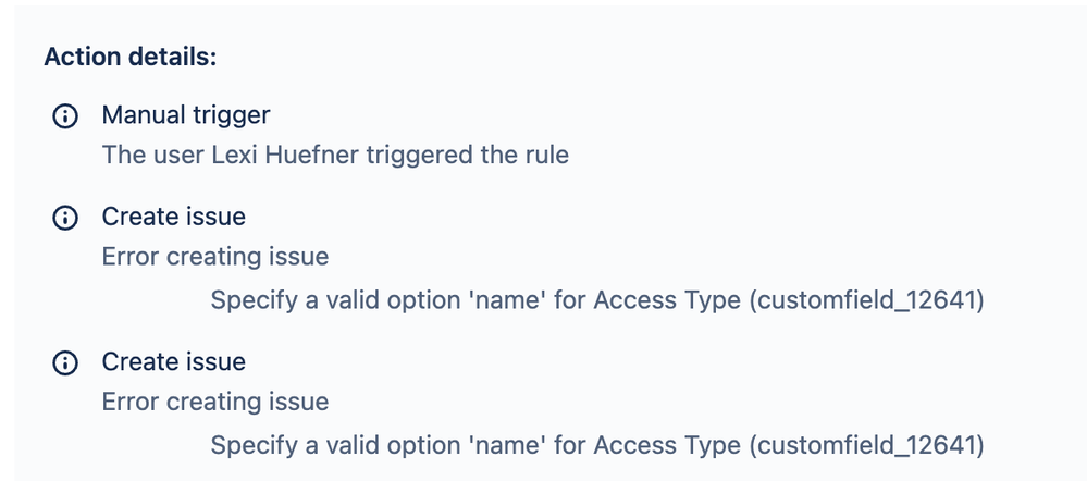

I am setting up automation to create subtasks on tickets created from our service desk. I have to set a required cascading list field. All of my JSON is working except for the following:
"fields": {
"access_type": { "value": "Google Workspace / GSuite (manual approval rqd)" }
"fields": {
"access_type": { "value": "iLMS - Inspired eLearning (manager approval)" }
For comparison this one does work:
"fields": {
"access_type": { "value": "Active Directory (manual approval rqd)" }
I suspect it's related to the "-" and "/" in the ones that aren't working. I am new to JSON and I couldn't find anything to indicate I needed to escape out of those characters but maybe I'm wrong. I'm not sure where else to look. any help is appreciated!

Lexi Huefner
May 2, 2023
