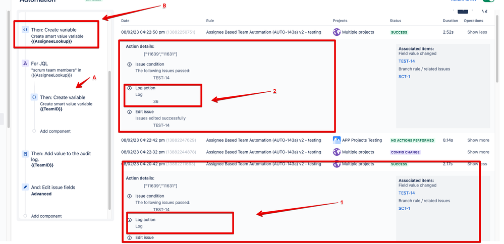

I am not sure if this is intended or it is a bug, but I wanted to share and see what others think.

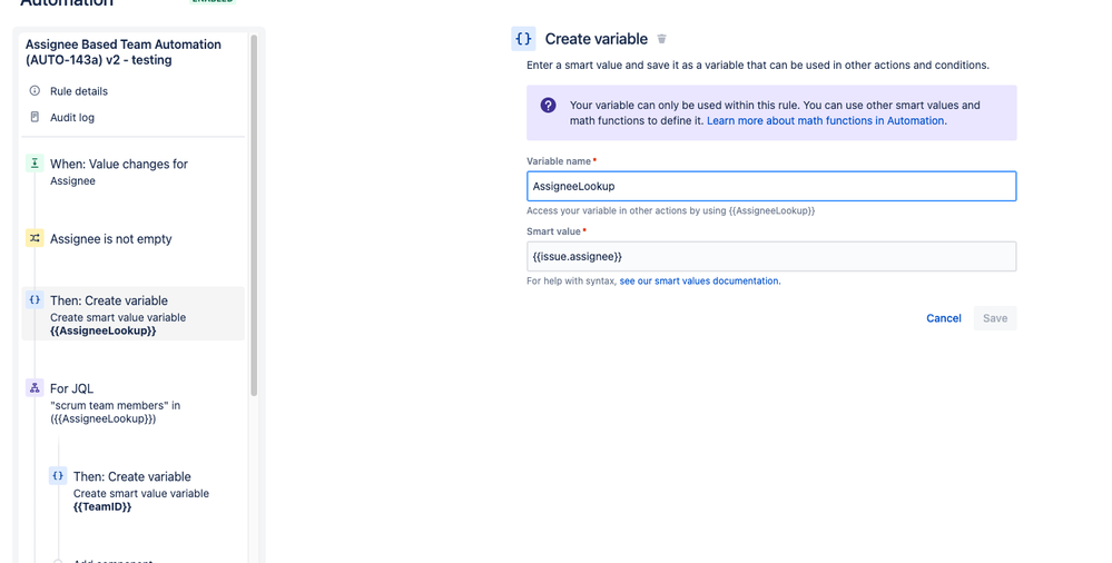

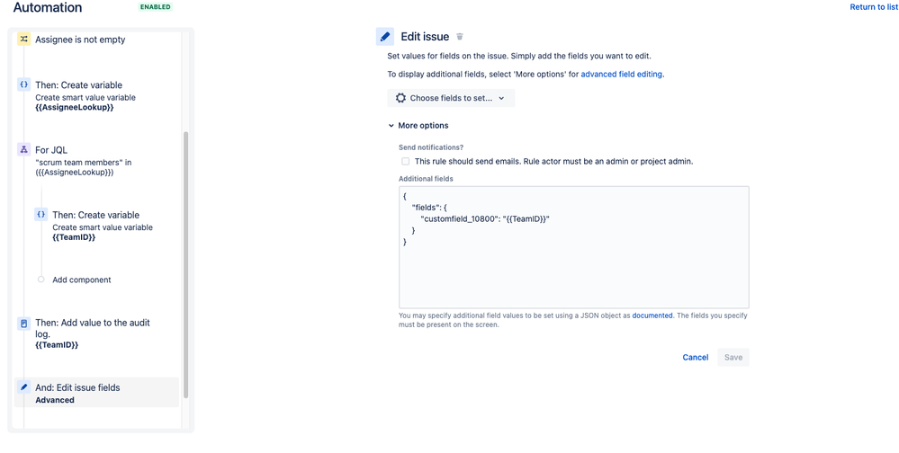

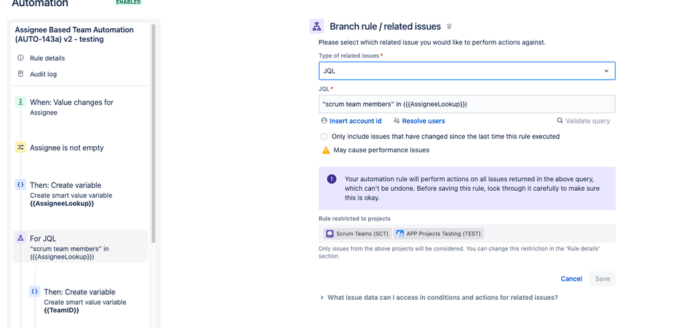

I am trying to create a variable inside of a branched JQL lookup and then use that variable outside of the branch.
Referring to my below screen shots, I was trying to access Variable A in the "Advanced Edit" at the bottom of the automation rule (which was located outside of the branched rule.
You can see in box #1, logging the action produced no result.
However, when I added Variable B (at the top) before the branched rule, it then changed something which then allowed me to access variable A outside of the automation rule (refer to box 2) which shows the log action.

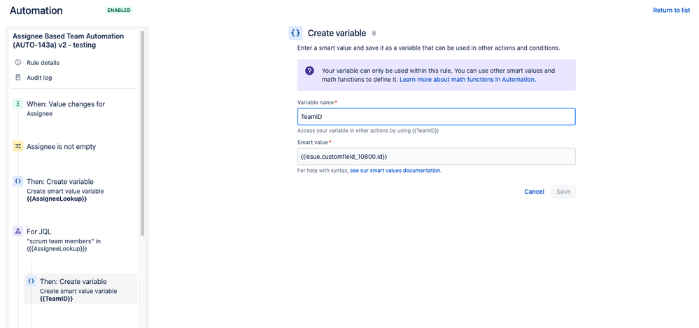

Below are screen shots of the entire automation rule if anyone wants to see what I am doing. The custom field 10800 is the Teams field that comes from Advanced Roadmaps, and has limited functionality inside of the automation tool, so I must manually manipulate it.

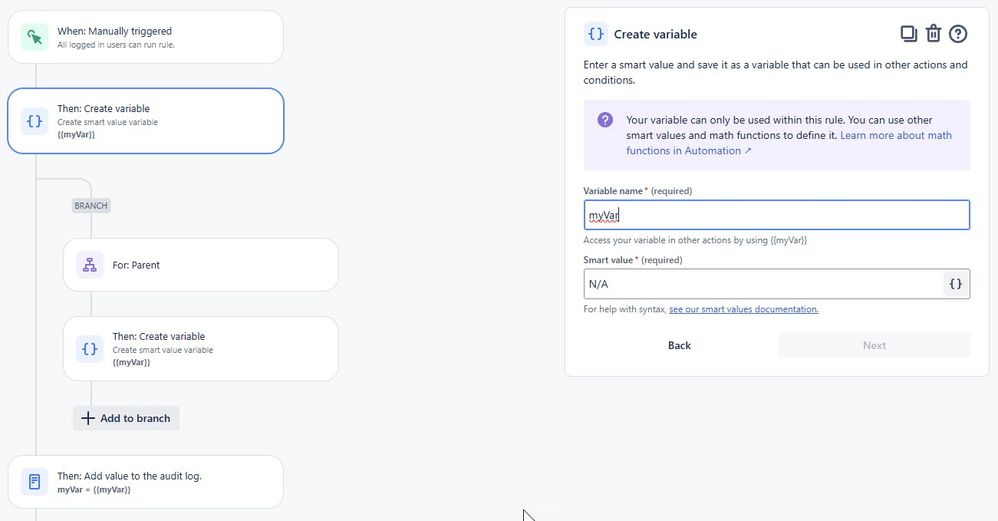

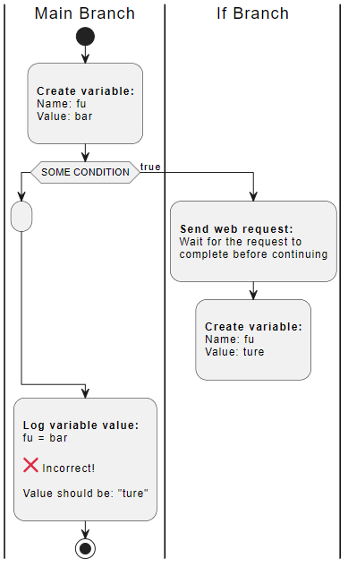

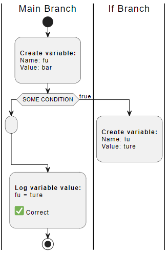

I know this is an old question, but I think I have the answer. Any variable created within an IF Branch or a FOR Branch will not be in scope outside of the branch. However, if you create the variable at the very beginning and give it a default value, you can then give it a new value within your branches, and it will be in scope anywhere in the automation.
When I run the automation and check the audit log, the value of myVar is the value set in the branch.

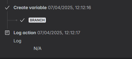

Duzmath Lajos
July 4, 2025
@Bentley_ Andrea
Is this still working?
I cannot get it running in my Cloud instance.

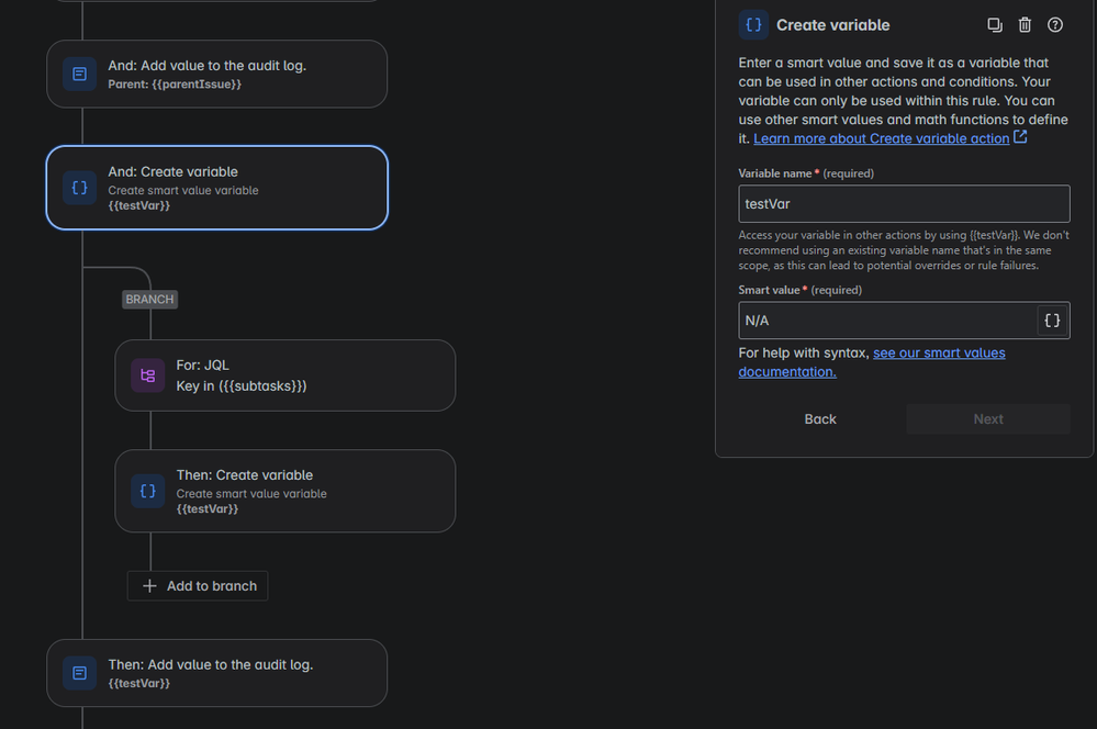

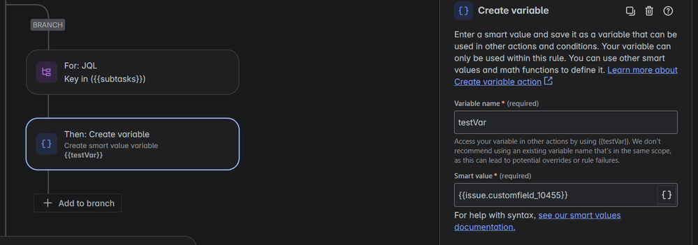

Inside the branch, the value is set to this:
After the branch, in my log I still get this value:
So the value of the variable does not change :(
Your help would be highly appreciated, this is blocking 2 of my important developments.
Thanks in advance!
Bentley_ Andrea
July 7, 2025
@Duzmath Lajos your Audit Log shows that your For JQL branch is not executing - that's why the variable value doesn't change.

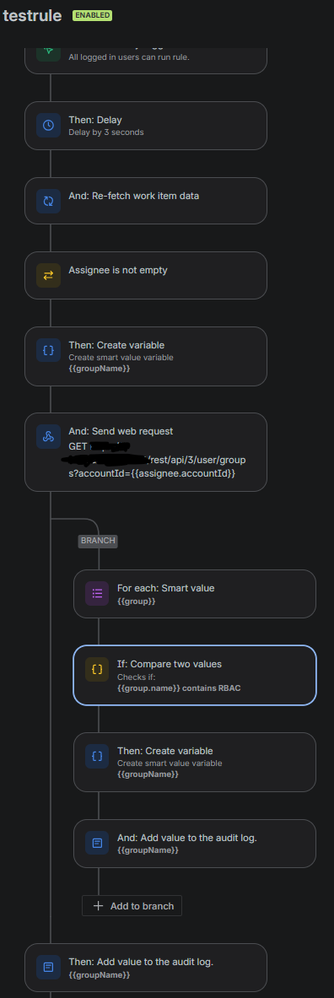

Danielle Alota
October 23, 2025
Hey @Bentley_ Andrea  - hoping you could share some further light into where I'm going wrong.
I'm trying to find the team that a user is in via group membership. Steps I'm thinking:
1. Find group that contains "RBAC" that user belongs to. (eg. RBAC-Payroll)
2. There is a team named just "Payroll" (different to group name).
3. Find that team with another API call (not captured in image)
At the moment, I'm having trouble pulling out the group name out of the for-each loop that iterates through all the groups.
First {{groupName}} has empty. Second {{groupName}} has RBAC-Payroll (confirmed with first log). But then second log still prints empty. Any ideas?
Bentley_ Andrea
October 24, 2025
No, sorry - I have no idea! It looks like it should work? When you create {{groupName}} the first time, are you setting the value to an empty string?
