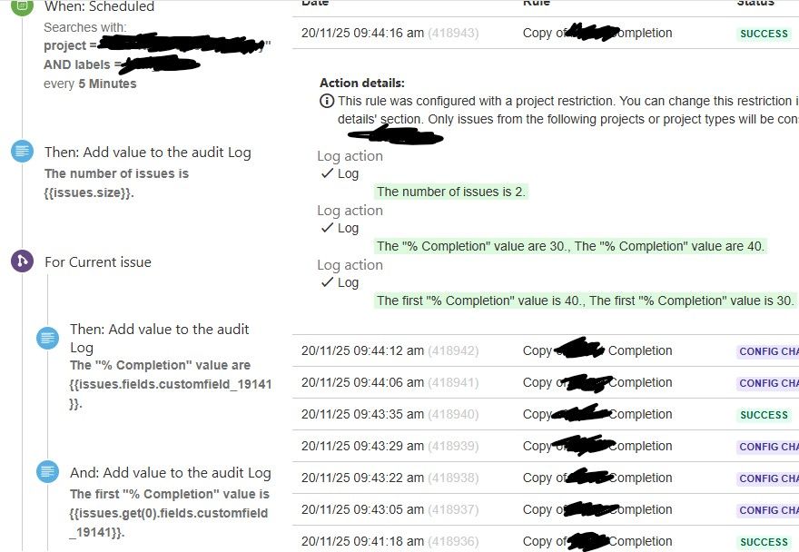

I understand that a work-around about the current Jira DC lookup limitation over custom fields is to code an automation rule with When=Scheduled and then select the bulk option.
My question is: given that (the automation rule), is there a way now to store the same/specific custom field of all the issues coming from the applied JQL in a variable?
So, I can use these variables later on in the automation rule in order to make calculation?
As you can see below, I have used this syntax {{issues.get(0).fields.customfield_19141}} but it gives (as expected, I think) the values of all the issues found (in this case 2):
I use Jira DC version 9.12.24.

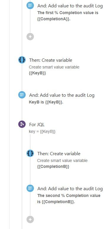

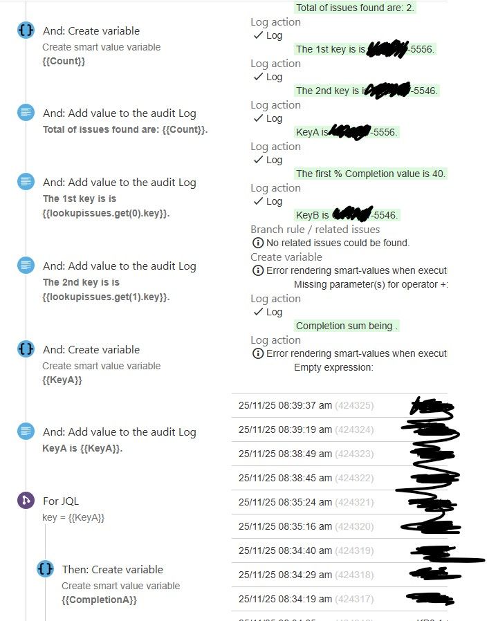

I would like to calculate the mean average of all the completion field values coming from all the JQL issues.
In my example, the total of issues is 2, completion value for issueA is 40 and completion value for issueB is 30.
I have applied then the workaround as described in the article you posted but I can get only the value of the first issue and not of the second: that's the meaning of the workaround being partial? Working only for the first issue?

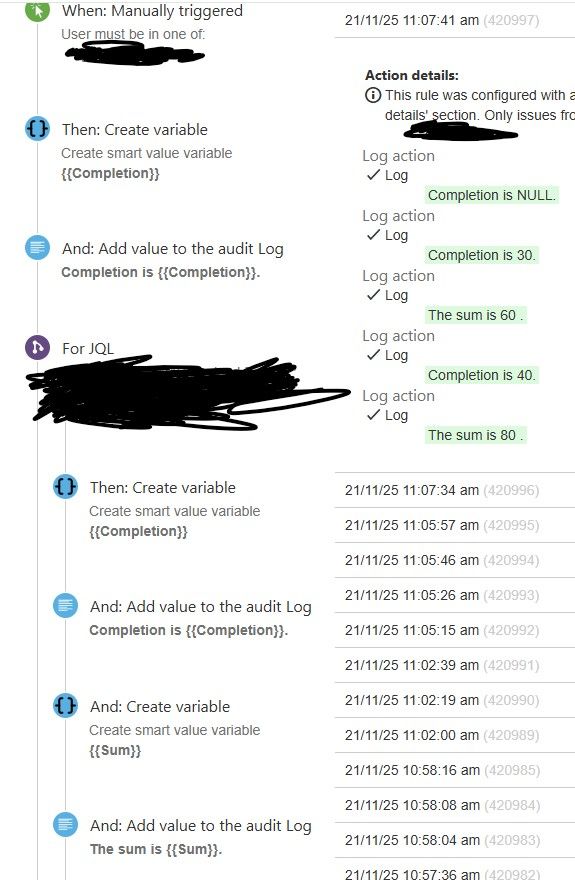

vincenzo.spatafora
November 21, 2025
Thanks @arielei.
Do you mean something like this:
Completion_Average.jpgAs you can see, it gives me the sum of itsself.
How can I store the single value such that the sum is (in this example) 70?
And on 70 I need to work out then the mean avearge, so, in this case 35.
Thanks, Vincenzo.

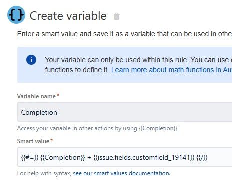

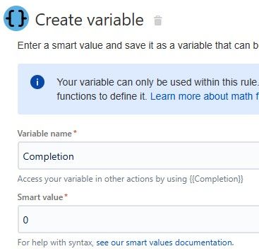

arielei
November 21, 2025
Hey @vincenzo.spatafora
First, set the Completion before the branch to "0" instead of Null.
Then, inside the branch when you create the var write:
{{#=}}{{Completion}} + {{issue.Completion}}{{/}}
Note - {{issue.Completion}} is the value from the issue - i guess that is what you are doing in the var.
Let me know if that works.
Ariel.

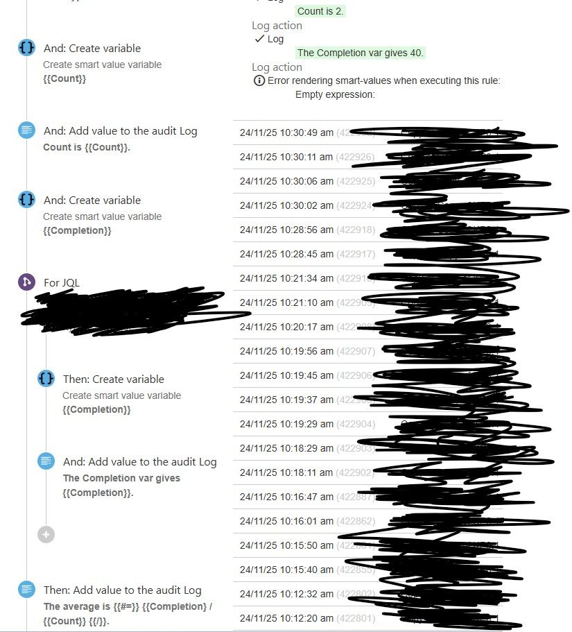

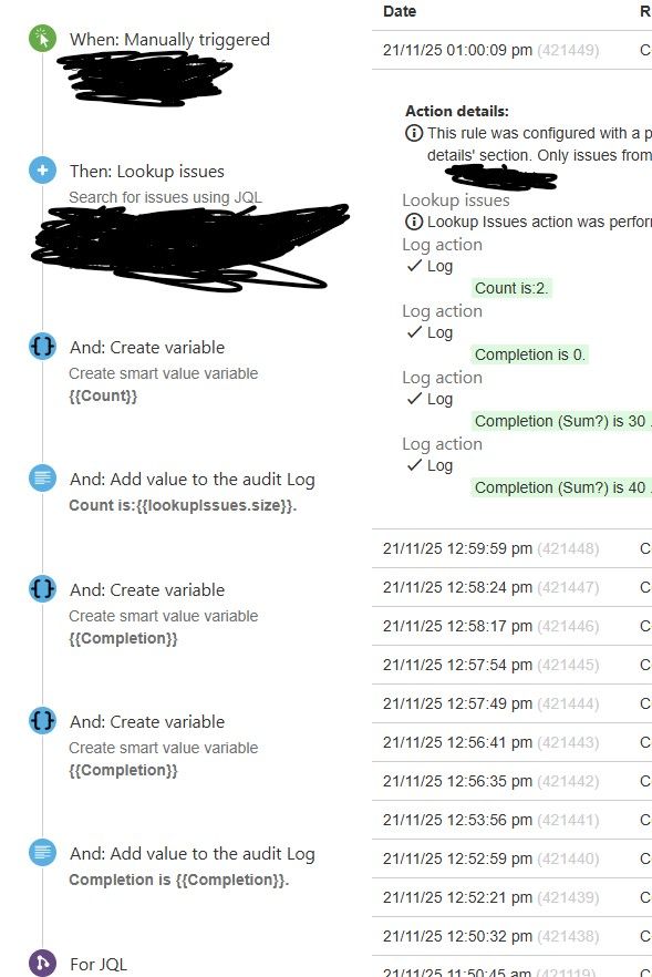

vincenzo.spatafora
November 21, 2025
So @arielei,
here what I have done and still not working.
Where is the error?
Where the var Completion is this smart value : {{issue.fields.customfield_19141}}; in the first "And: Create variable".
While in the second "And: Create variable" I set Completion to 0 (as smart value).
Thanks a lot,
Vincenzo.

arielei
November 24, 2025
Hello @vincenzo.spatafora
I understand,
So like i wrote above:
1. create a var outside the branch with value 0.
2. create a var that holds the number of issues by doing lookupissue on the JQL.
2. inside the branch, create the same var but the value will be
{{#=}}{{VAR NAME}} + {{issue.Completion}}{{/}}
3. after the branch,  simply do
{{#=}}{{VAR NAME}}/{{lookupissue.size}}{{/}}
In DC that should work.
Let me know.
Ariel.
vincenzo.spatafora
November 24, 2025
Thanks @arielei.
I've done that but it seems not working:
1. (outside the branch)
2. (inside the branch)
And here what I get:
Thanks in advance, Vincenzo.
