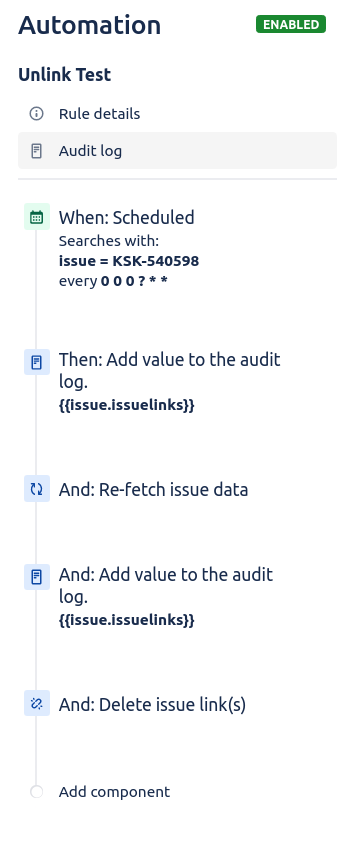

I'm attempting to create an automation that will unlink tickets after 'x' amount of days. I figured that this should be fairly simple as "automation for Jira" has an action to 'delete issue links'.
  1. Trigger - Cron Scheduled w/ specified JQL
  2. Delete Issue Links

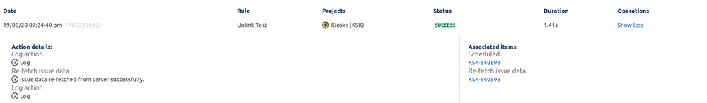

Ran the automation and it succeeds in locating the ticket but "No actions were performed"
I was able to locate a similar issue with a work around but has not worked for me (AUT-1925 )
Following the steps
  2. Add value to the audit log - {{issue.issuelinks}}
  3. re-fetech issue data
  4. add value to the audit log - {{issue.issuelinks}}
  5. Delete issue links
Screenshot from 2020-08-19 19-27-04.pngScreenshot from 2020-08-19 19-28-04.png

Hi @Dennis Zhao
I tested this rule in our instance and it worked fine (albeit I used a manual rule run).
Can I confirm what the value of steps 2-4 are? Just want to confirm what the audit log steps are doing for your rule!
Ste
