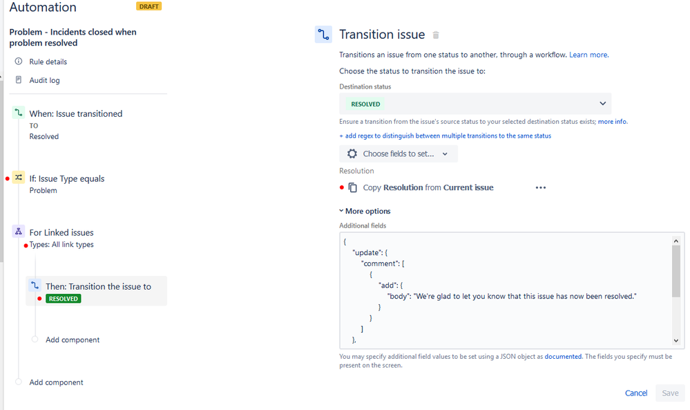

I have the rule set that if an issue type is "Problem" and the status is set to Resolved, then set the status of all linked issues to Resolved, and copy the resolution from the trigger issue.

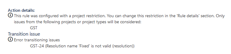

However, it's failing with the error: GST-24 (Resolution name 'Fixed' is not valid (resolution))

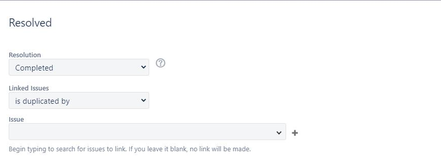

When closing the Problem issue, the resolution that was selected is called "Completed". "Fixed" is not a resolution we have available.

It seems the rule was broken. I re-created the rule with the exact same criteria (and corrected the "Copy from..." to say Trigger issue rather than Current issue) and it worked.

That was a red herring, because that was a change I made after the original error occured.
The rule originally was to set the Resolution to Completed, rather than copying it from the linked issue. This is when the "Fixed" error first occurred.
I then changed it (incorrectly) to copy from the current issue, which produced a different error, unrelated to the first.
I think the initial automation was broken somewhere in the background and was looking for a resolution of "Fixed" which didn't exist.

Thanks, I understand now, and have confirmed that both the problem issue and linked issue have a resolution of "Resolved" available.
The error states that the resolution "Fixed" is not valid, but I don't understand where this value is coming from, since "Fixed" is not a Resolution under administration > Resolutions. It seems to be a rogue value.

Wait, I see you have copy resolution from current issue. Should that be “from trigger issue”?
