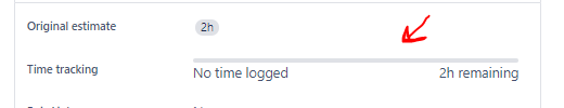

  2. Create a new Ticket with no time tracking information.
  3. Edit Ticket - Add 2h as Original Estimate
    • This will also setup the remaining estimate automatically to 2h
    • This will trigger the automation sucessfully

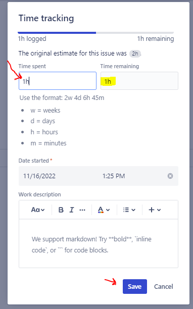

  4. Edit Ticket - Click on the "Time Tracking" Bar so the UI element pops-up:
    2. This will adjust automatically the value of "Time remaining" to the difference between the original Estimate
    3. Press Save

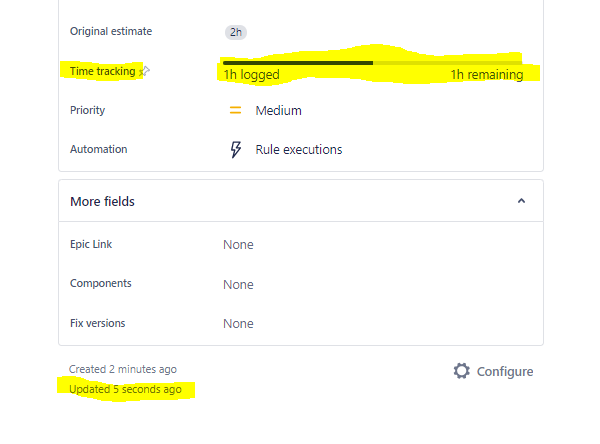

    4. This will not trigger the Automation
    5. The "Updated" timestamp shows that the ticket was actually updated.end.PNG

Trudy P Claspill
November 16, 2022
Hello @Gil Hilario
If you want to trigger a rule when a new work log entry is created, use the Work Logged trigger.
https://support.atlassian.com/cloud-automation/docs/jira-automation-triggers/#Work-logged
Gil Hilario
November 16, 2022
Thank you, that did the trick.
