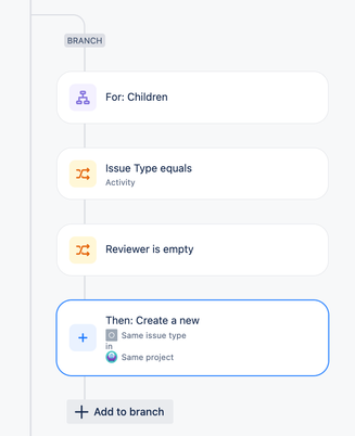

  • Children issues are copied in branches. There are multiple branches because I have different types of children issues and situations. For example:

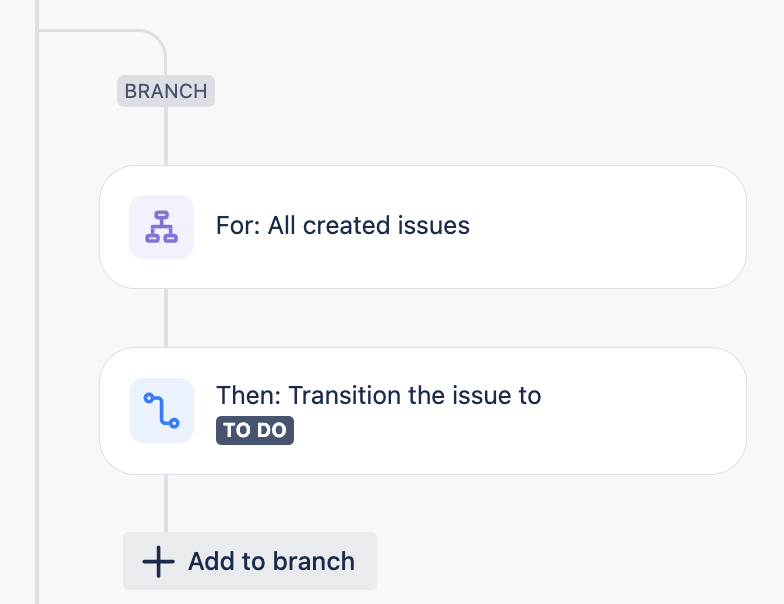

-> I have also tried to use a "for all created issues" branch (below), but again because branches run independently, some issues created in other branches are missed and remain in Status A.
