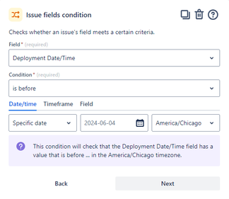

I am having some trouble with Issue Fields Condition as I can't use the startOfDay() JQL function.
I have tried the following using the JQL condition
"Deployment Time" < endOfWeek(-1)
Do I need to specify something further for the field potentially?

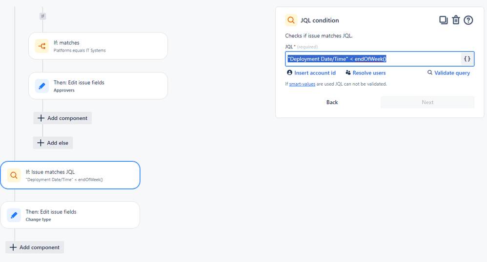

I used a JQL condition ""Deployment Date/Time" < endOfWeek()" to trigger the priority to set to an Emergency type.
The end results being that if someone submits a change request for the current week, additional approvals will be required and the type changes away from a Normal request.

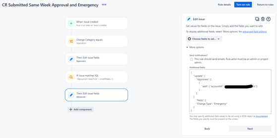

I've changed it to "if:Issue matches JQL" and have added the argument:
"Deployment Date/Time" < endOfWeek(-1)
The goal being if the issue is created during the same week, it will add a specific approver and then change the type to an emergency request. It should also check if a certain category is selected and have a set list of approvers for those as well.
