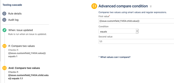

Sorry, I thought you were trying to 'Edit' the issue to set the value for field.
To define the 'If' rule for Cascading select, you can choose the 'Advance compare condition' option and write REST API check for a cascading select.
Place the custom field ID for the cascade select list in the rule below.
For parent value: {{issue.customfield_xxxxx.value}} equals value1
AND
For child value: {{issue.customfield_xxxxx.child.value}} equals child1

Thank you so much @Gikku
Advance compare condition works.
Much appreciated.
