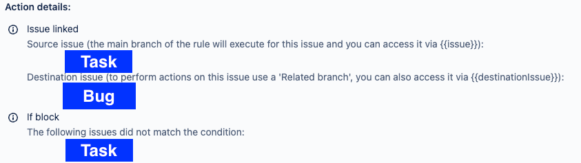

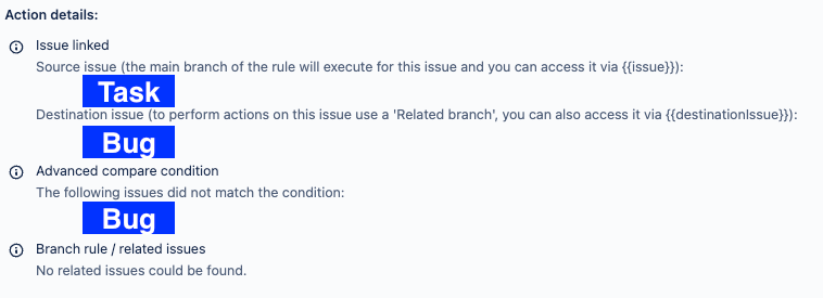

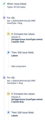

The test I am performing for the below is: I am in the bug ticket and link that bug ticket to a task.
When I tried the above:
I got the following "no actions performed message":

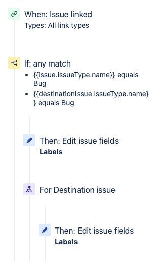

Which spawned the idea to try:
But I got the following "no actions performed message":
From what I can tell by looking at the second rule, it seems like even though the JQL condition is referencing the "{{destinationIssue}}" (Bug) it is still running the query against the "{{issue}}" (Task).

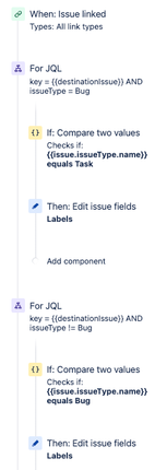

Sorry - Error on my part. Let's replace triggerIssue with issue in those two conditions (I've updated my last post):
{{issue.issueType.name}}
Richard Herrada
October 12, 2022
Hi Mark, the proposal did not work.
This is what I tried:
This is the no actions performed message:

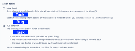

Thanks again for the response @Mark Segall !  Upon attempting the above, I received the following No Actions Performed message:

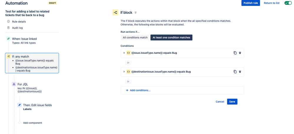

Are both of these issues on the same project? I ask because if they're on different projects, you'll need to update the project scope (rule details).  This would need to be done by a Jira Admin under Settings >> Global Automation.
And for the IF condition did you make sure to change it so that it acted as an OR instead of AND?
Richard Herrada
October 12, 2022
Yes they are.

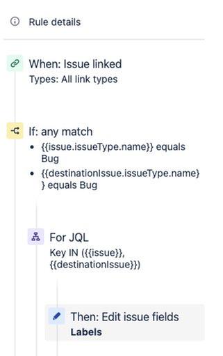

Ok - No idea why it has to be set up this way, but I got it to work when I did this:
For some reason, when you use a JQL, it automatically adds "AND Key != {{destinationIssue}}" which makes no sense to me.  So, I went with the above and it worked for me no matter how I set up the links.
Like • Richard Herrada likes this
Richard Herrada
October 12, 2022
@Mark Segall You did it!!  This seems to be working beautifully. Thank you so much!
