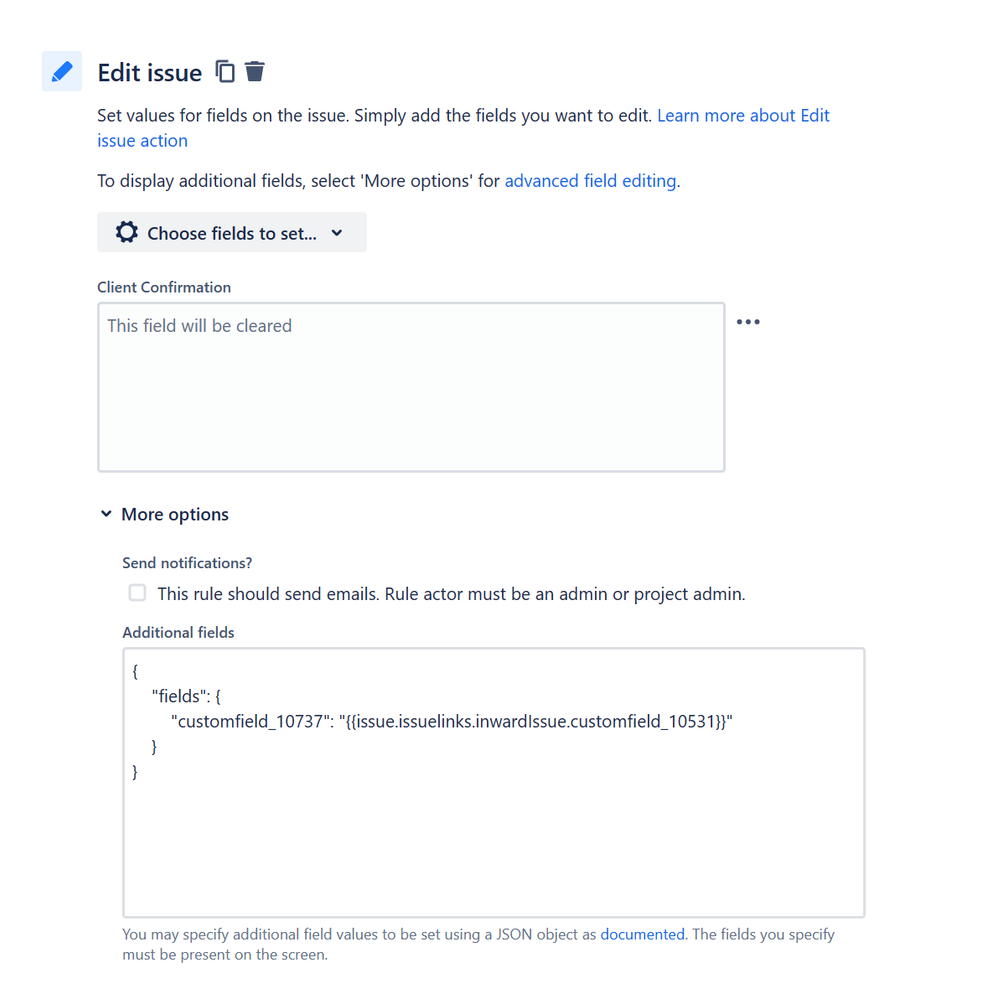

For clarification, I have Jira Cloud. I am trying to create an automation that copies a custom field called "Relative Control Weighting (1-10)" (customfield_10059) from the linked issue into a different custom field called "Control Weighting Score" (customfield_10079) in the current issue.
The source field is a Dropdown type. The destination field is a text type (since I found you cannot do this on a dropdown type)
After reading up on this link, I have:
When: Issue Linked - Type: Related to
Then: Edit issue field - Advanced
"fields": {
"customfield_10079": "{{issue.issuelinks.inwardIssue.customfield_10059}}"
The automation runs, but does not copy the source field to the destination field. In fact, I see nothing has changed. The audit logs show SUCCESS:

I have also tried using:
"fields": {
"Control Weighting Score": "123"
just to try to statically set the value to 123, but it does nothing.

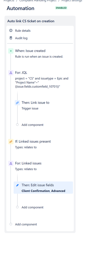

I figured it out!
My problem was I was attempting to update the issue that I was linking, rather than the issue on which I was creating the link.
Solution:
When: Issue linked, Type: Relates
For Linked issued: Types: Relates
Then: Edit issue fields...

The rule has changed slightly from when I first created it. I changed "relates" to a new custom verb "satisfies". Other than that it should be essentially the same rule. I added several custom fields I needed copied, but it all works. Note in the second screenshot I had to do both verbs "satisfies" & "is satisfied by". I can't remember if I did both and just never removed one, or if they are both indeed needed. Hope it helps.
Screenshots Here
