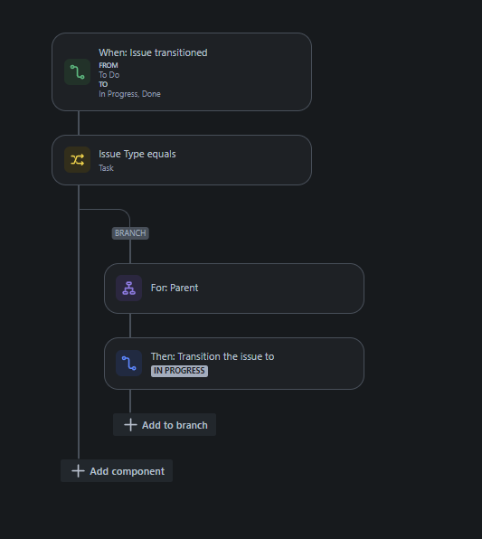

can I create an automation for putting a Epic in progress once any task within an Epic is moved into progress status?
sometimes the Epic is in backlog, but some tasks are starting to get some traction and move work to in progress but the Epic remains in backlog until I go to check.
Thanks!
5 answers
2 votes
Collista Lewingdon
February 20, 2024
Here is a rule that I created that does just that. 2024-02-20 11_26_36-Settings - Jira.png

Enmanuelor Ortiz Lopez
February 28, 2024
Thanks @Collista Lewingdon that worked marvelous. ⭐️⭐️
even I’m using Server Jira, that helped.
thanks a los for your help!
regrads!
Like Collista Lewingdon likes this
February 28, 2024
Thank you all for your answers… unfortunately I’m not able to use any plugin or install anything.
so, @Collista Lewingdon solution worked perfectly for me.
Regards!

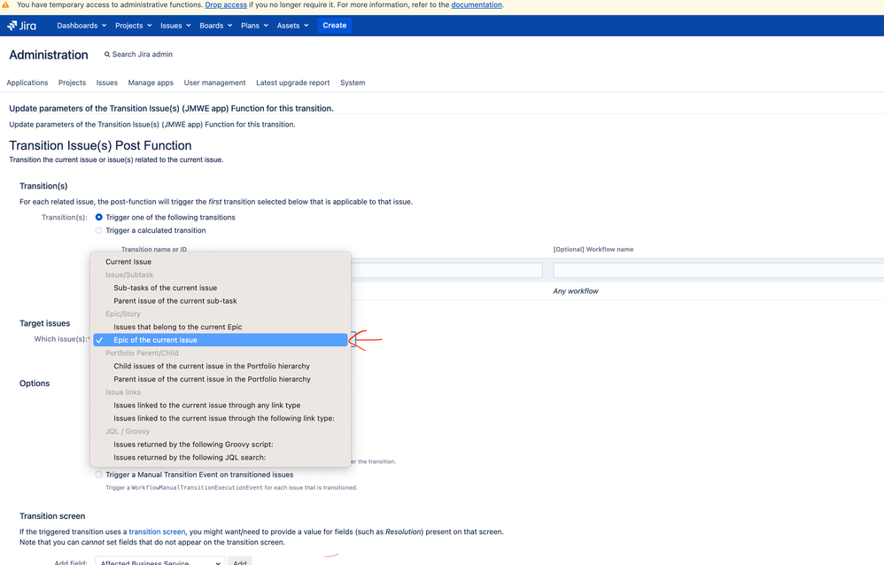

Teja_Appfire_
February 20, 2024
Hi @Enmanuelor Ortiz Lopez ,
To achieve your requirement using Jira Misc Workflow Extensions (JMWE) app, follow these steps:
  1. Install Jira Misc Workflow Extensions (JMWE): If you haven’t already installed JMWE, you need to install it from the Atlassian Marketplace. You can find it here.
  2. Add Transition Issue Post-Function:
  • Go to your Jira project.
  • Navigate to Project settings > Workflows.
  • Edit the desired workflow that you want to modify.
  • Click on the transition where you want to add the post-function (e.g., “In Progress”).
  • Select the transition, then click Post Functions.
  • Click Add post function and choose JMWE: Transition issue from the list.
  1. Configure Transition Issue Post-Function:
  • In the Transition Issue configuration, you’ll find an option to select the Target Issue.
  • Select the appropriate target issue for the transition.
  • Ensure that this post-function is positioned after the “Update change history for an issue and store the issue in the database” post-function. You can drag and drop the post-functions to reorder them.
Screenshot 2024-02-21 at 10.16.54 AM.pngScreenshot 2024-02-21 at 10.18.23 AM.png
By following these steps, you’ll be able to transition the issue and select the target issue as required
Thanks,
Teja
