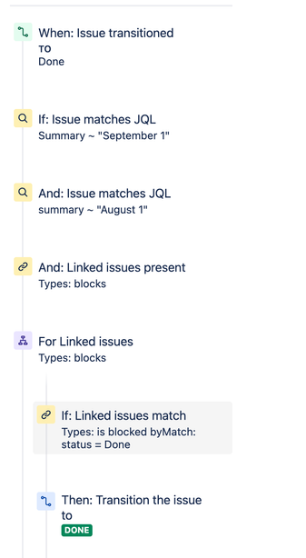

Hello, I am trying to auto resolve the main issue when the linked (blocked by) issues are resolved. I came up with this automation below. It seems like nothing happens when I change the linked issues state to done. The main issue is still in submitted state. Any suggestions will be appreciated.

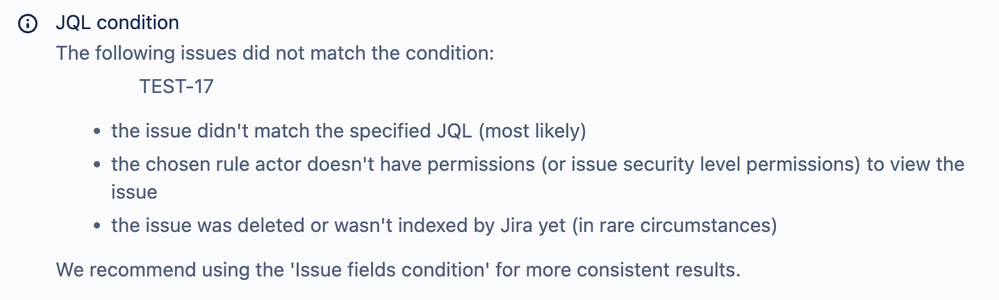

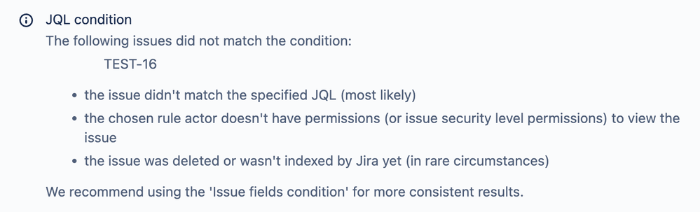

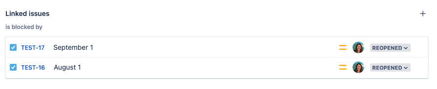

Elif Alverson
August 16, 2022
@Bill Sheboy and @John Funk ; here are the details. and my test linked tickets.Screen Shot 2022-08-16 at 7.07.46 PM.pngScreen Shot 2022-08-16 at 7.09.22 PM.pngScreen Shot 2022-08-16 at 7.09.27 PM.png
Charlie Gavey
August 16, 2022
Hi @Elif Alverson
It looks like your JQL may be filtering for only issues that contain both "September 1" and "August 1", rather than issues that contain either one of these.
If you try removing one of your JQL conditions, so it's only matching on one of the strings, does your rule successfully trigger against one of the test issues?

Bill Sheboy
August 16, 2022
Yes, I think Charlie identified the cause: your rule structure is performing an AND of the two conditions.
To still include both, switch to one condition with:
summary ~ "September 1" OR summary ~ "August 1"
