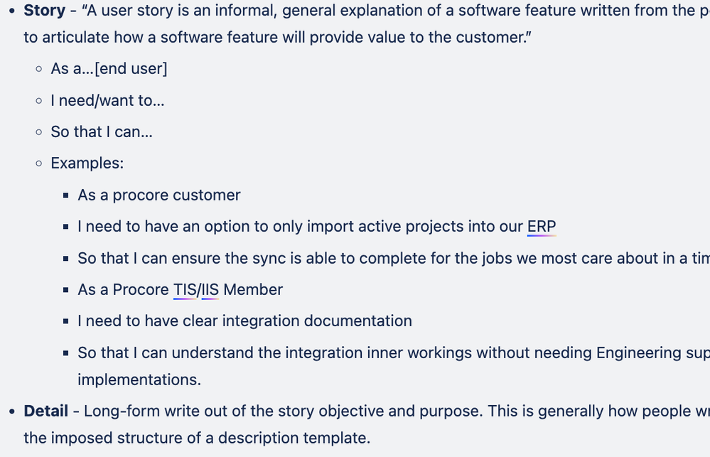

Hi Team,
I am trying to auto-populate a nested list in the description field with behaviour, but I am unable to find options other than ordered and unordered lists. I am looking for something similar to what is shown in the picture.
Referred document :
https://developer.atlassian.com/cloud/jira/platform/apis/document/nodes/listItem/

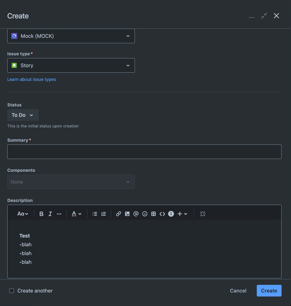

I gave a basic test in my environment with this code:-
const descriptionValue = getFieldById("description").getValue();
let str = "blah•blah•blah";
let strArr = str.split("\u2022");
let newStr = '\u2022' + strArr.join("\n\u2022");
// If description field is wiki markup access the content property
if (typeof descriptionValue !== "string") {
const descriptionValueContent = descriptionValue.content.toString();
if (!descriptionValueContent) {
getFieldById("description").setValue({
"version": 1,
"type": "doc",
"content": [
"type": "paragraph",
"content": [
"type": "text",
"text": "Test\n",
"marks": [
"type": "strong"
"type": "text",
"text": newStr
Please note that the sample code above is not 100% exact to your environment. Hence, you must make the required modifications.
Below is the output that I was able to achieve:-
I hope this helps to answer your question. :-)
