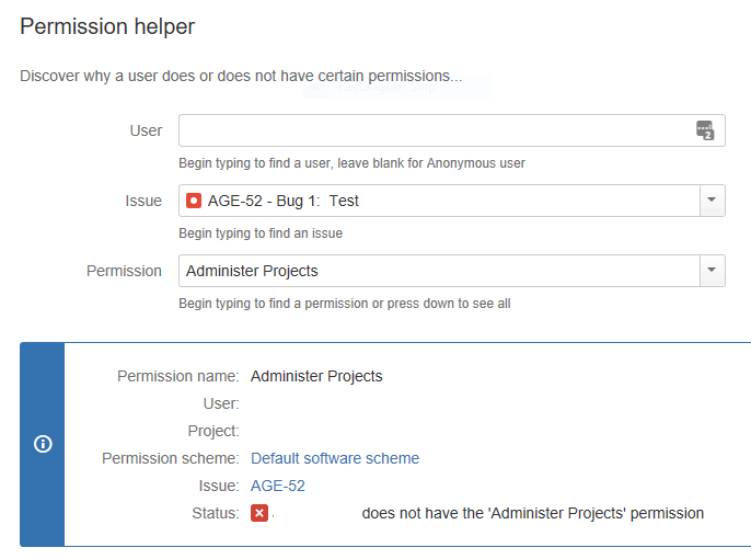

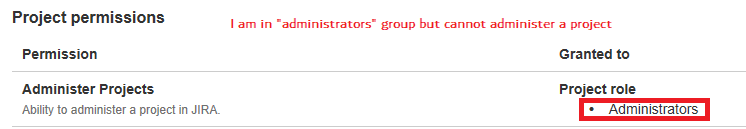

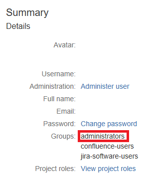

Since assigned to the "administrators" group, how is this possible below ?
Cap1.PNGI am assigned to the administrators group.  The documentation uses the terminology JIRA System Administrators, JIRA Administrators, Administrator, Project Administrator, and Board Administrator - but all in different parts of the documentation.  The Settings uses Administrator - which I assume applies to any "Administrator."
So to which group does an "administrators" assigned Group member belong ?

Hi HJLBX - Roles and groups are different things.
Your user is in the 'administrators' group, but the 'Delete issues' permission is given to the 'Administrators' role. If the 'administrators' group does not hold the 'Adminsitrators' role in the project you are interested in, then people in that group won't be able to delete issues.
Based on your previous queston, I think you are using JIRA Cloud, so I'll refer to the Cloud docs in links below.
To see what JIRA-wide permissions people in the 'administrators' group have, check the global permissions.
(but note that in JIRA Cloud, the 'JIRA System Administrators' global permission is not generally available, becasue it is restricted to Atlassian Tech Support).
To see what project-specific permissions people in the 'administrators' group have, look at the permissions scheme that applies to the project you are interested in. If the scheme grants permissions by project role (as you screen shots show), then you need to check 'Users and Roles' inside the project settings.

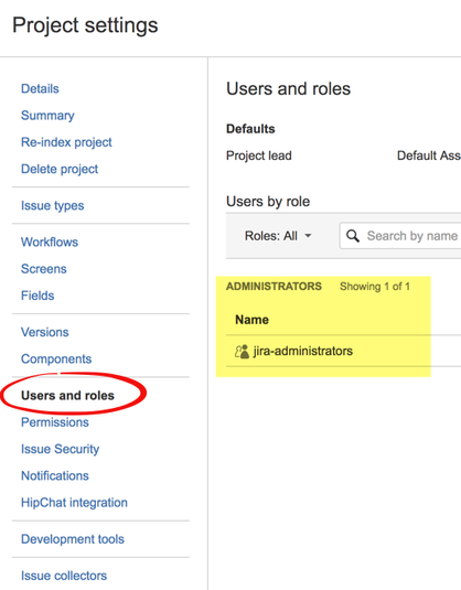

One way check 'Users and Roles' in JIRA Cloud:
  • Select your project from the Projects menu at the top of the screen
  • Once in your project, click Project Settings (the cog icon) in the left hand nav bar
  • Then, on the 'Project Settings' page, click Users and Roles.
With the default set-up, you'll probably see something like this:
What this shows is that people in the 'jira-admistrators' group have the 'Administrators' role for this particular project, but people in the 'adminstrators' group do not. Something like this probably explains why your user can't delete issues.
Putting them in the 'jira-adminstrators' group will probably solve the problem for you.

So who gets the project role 'Adminstrators' by default?
To check go to JIRA Administration > System > Project Roles.
FInd the project role with name 'Adminstrators' and, in the 'Actions' menu on the right click Manage Default Members.
This will show which groups get given this role in a project when it is created. I think you'll see just the 'jira-administrators' group here.

If we assign the "administrators" Group to the Administrator's Role, will this allow the "administrator" to delete?
Yes - assuming your project uses the default permission scheme, which has the 'Delete Issues' permission granted to the 'Administrators' role.
To change existing projects, you'll need to do this using 'Users and Roles' from within the project settings.
If you want this to happen in all new projects created in future, you can use JIRA Administration > System > Project Roles > Manage Default Members.
Another opton is to simply grant the 'Delete' issues permission directly to the 'administrators' group, then they don't have to hold any particaular project role to be able to delete issues.
