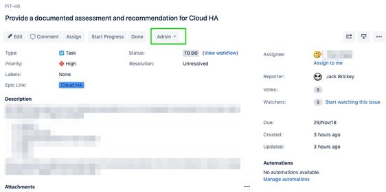

can you add a screenshot of your issue view. similar to below. if you have the Admin button then see if you can add Epic Link if it does not show.

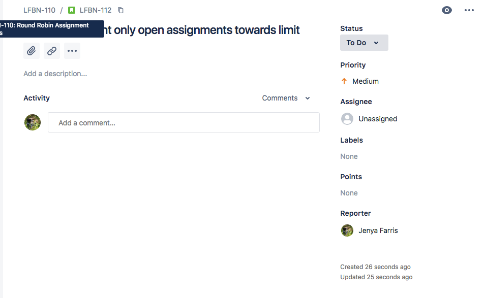

this screenshot by the way is of a story ticket I created under a new epic, and as you see even on the issue detail view it doesn't show that it is under my epic. But I can see it in my backlog list

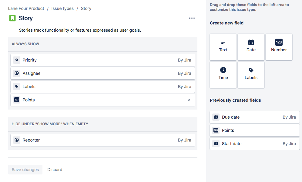

I did follow the instructions in that post, but there is no Epic link field in the options.

LMK if you are able to edit the screen. note that you need to be admin for this.

Unfortunately no, the Epic field is not on the list of possible fields to add to the page (my screenshot above is all I've got, and the points field is a custom one I created because thats not available yet either).

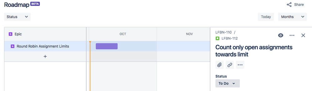

And yes, they just released the epic type and a roadmap function that I'm super excited to use, but just annoyed that my existing backlog can't be merged in

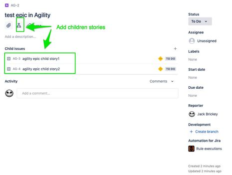

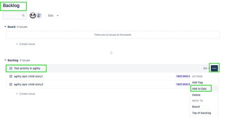

@Jenya Farris, so here is what I have found and bare with me as I don't use Agility as yet so still learning.
@Jack Brickey You are the BEST! How did you find it (screenshot 2)? Mine says "Change Epic" instead of "Add to Epic" even on stories with no Epic yet, but I am so happy this is there. Now I can go and merrily start organizing my backlog into Epics.
Thank you again!!
you are most welcome. I just borrowed from past experience where I could drag issues into epics in the backlog and hope that maybe they carried that forward in some way. I'm actually encouraged by the new Agility and am confident it is going to become part of my daily projects but there is so much changing there I have held off. Historically there has been too much missing for my tastes but it is clearly getting there.
