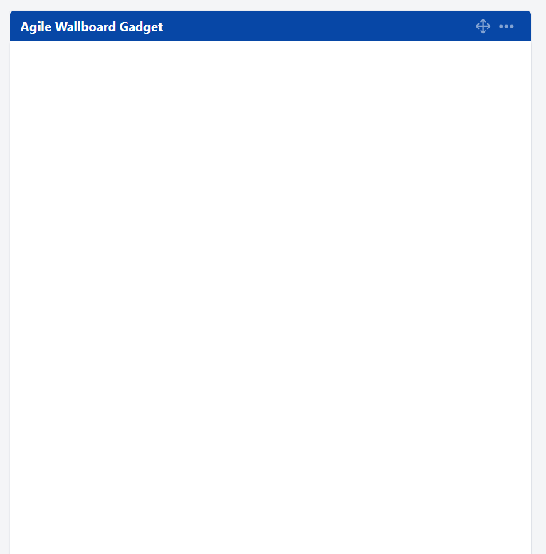

Hi @venkatesh
although I have no solution right at hand I'd suggest having a look into Jira's application logfile - assuming your tag "Server" is correct so you or your Admin can check.
The article "Useful log files in Jira"...:
...will help in identifying the logfile - keep a look for "atlassian-jira.log" and see if something is logged when you try to open the wallboard gadget.
Please post back any findings.

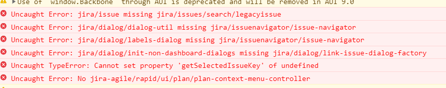

Hello @Daniel Ebers @Tinker Fadoua ,

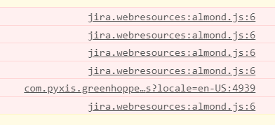

we are getting these errors. first is the error list in the Jira console and second is the file where those errors are coming. These are the javascript errors we are seeing in the browser console. It was high impacting Production Releases.
Q: Is there any plugin for that Agile Wallboard Gadget?
Please see attached Screenshots.
Thanks!
These are not the server logfiles but something that was gathered from the console of your browser. I suggest double checking with your server administrator like said previously if any error from logfile is visible.

Hello @Tinker Fadoua thanks for quick response we are not change anything in recently ,that was stoped we did not configured any thing before 10 days It was working
Did you try to remove it then add it back?
Did you start a new Sprint?
Any change made on the filter?
@Tinker Fadoua I am already so many times add back but still it was not showing
and it will effect on Production Jira
@Tinker Fadoua and in My test test instance It was working This On Only not working in Production

Hello Deyves ,
Thanks!
