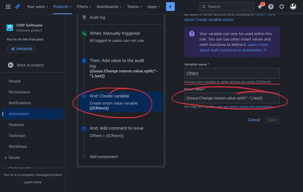

Jack Brickey
September 12, 2023
Hi @Adam Rosenbaum , I was playing around with this concept a bit and determined that it might be better to simply use the "split" function within automation. Below is an example of this in action. Basically, you would leverage the field value naming convention I mentioned previously but instead use a dash as the parentheses I believe it's a reserve character will not work.
{{issue.Change reason.value.split("-").last}}
in this example I referenced my Change reason field where I had one value listed as Failure - 7. The below automation properly extracted the 7 and placed it into my variable which I then used within a comment action simply to test. Oh, and the Log action was just part of my test as well but useful when creating automations.
