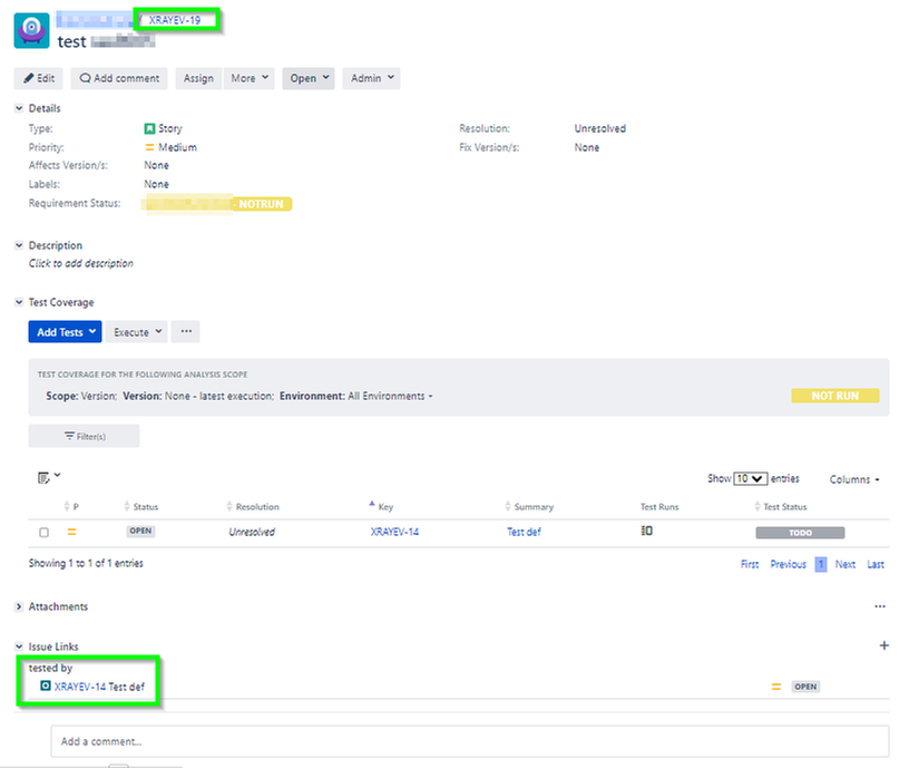

I tested this - technically it works exactly as I described. As long as a test case is within a test execution - when the test case is linked with "TEST" linktype to a requirement AND the issuetype of the requirement is configured as a coverable issue (in xray settings) - the coverage is shown (a requirement will always show test executions where its own tests were run).
I did the follwing POST call:
{{baseURL}}/rest/api/2/issueLink
JSON Payload:
    "type": {
        "name": "Tests"
    "inwardIssue": {
        "key": "XRAYEV-14"
    "outwardIssue": {
        "key": "XRAYEV-19"
    "comment": {
        "body": "Linked test issue!"
wheras "XRAYEV-19" is the covered Story and "XRAYEV-14" is my test case.
Results in:

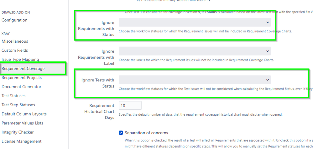

So I would recommend to re-check the xray settings:
- is your issue type (requirement) configured in the xray settings "Issue type mapping"
- please also check the requirements coverage section in the xray settings:
As mentioned it´s simply a rest api call so it can be executed from gitlab pipeline.
Please share everything you´ve done so far (calls, payloads, etc) and also screenshots to know where you ended up and got stuck.
