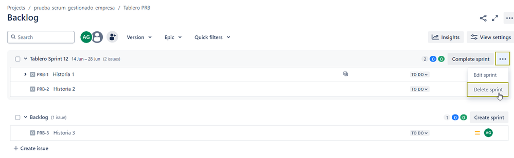

If I understand correctly you mean that you have removed from the sprint all the issues that were in it and yet it still appears. This is normal, because the sprints belong to the Scrum board and even if you remove all the issues that were in it, it still exists, if you want it to disappear you have to remove it directly. To do this, click on the three dots on the right in the sprint and Delete sprint.

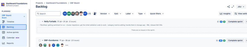

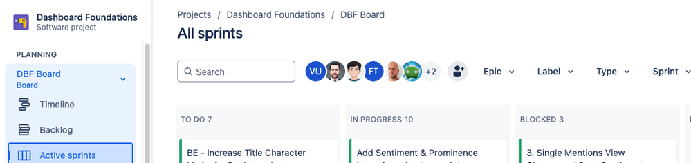

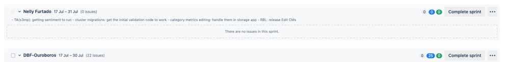

Below is project B's board - you can see two sprints running at the same time, Sprint Nelly Furtado with zero issues + DBF-Ouroboros with 22 issues

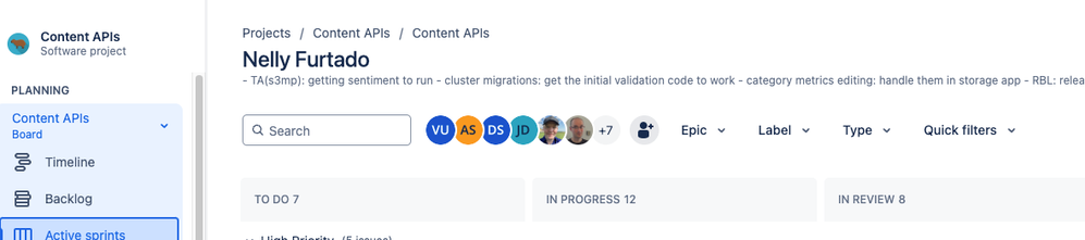

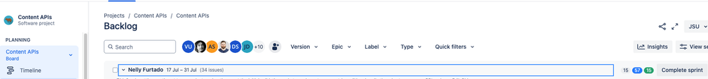

Below is project A's board - only the Nelly Furtado sprint is runningimage.pngimage.png
Adrián García González
July 23, 2024
Thanks for that,
It sounds like you're suffering from a case of shared sprint. To check if this is the case and to know what you can do, I leave you this article that will help you: https://community.atlassian.com/t5/Agile-articles/Knowing-when-you-have-a-Shared-Sprint/ba-p/944613
