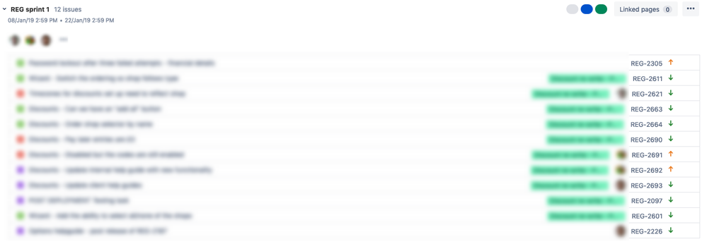

Sprint - as you can see REG-2504 does not appear in the list

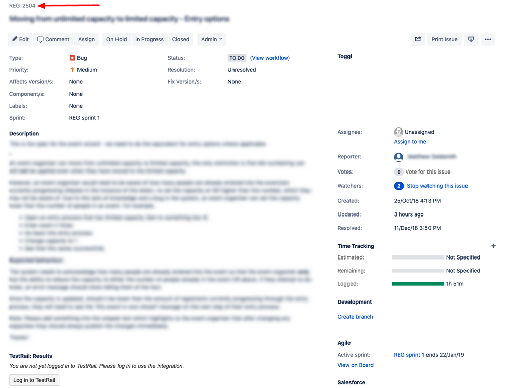

Ticket

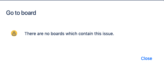

What happens when I click 'view on board' from within the ticket, despite the ticket clearly being marked as part of a sprint.

If you copy your board filter and use it for a JQL query and in the results you see the one issue displayed then I concur with @Thomas Deiler - build a new board and observe results.

  • The bug does not have a component/version
  • Its resolution is unresolved
  • The status of the bug is 'To do' so definitely mapped
As for being previously mapped to another sprint, that could be true but changing the sprint value should surely over come that?
